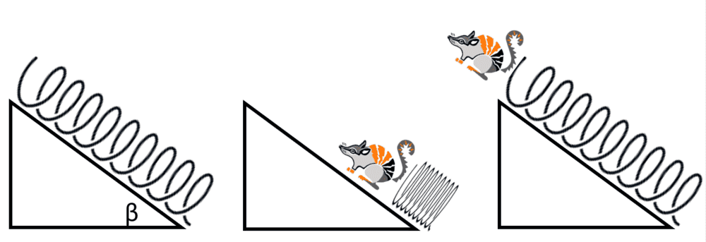

Genevieve the galah wants to test out her new creation - the Nifty Numbat Launcher. It consists of a large, ideal spring with equilibrium length l1 = 1.7 m and spring constant k=41 N/m. The spring rests upon a ramp of length l1 inclined at an angle β=30∘ to the horizontal. The spring is attached to the bottom of the ramp. Genevieve compresses the spring to a shorter length l2 = 0.4 m, and convinces her mate Nigel the numbat (mass m = 2.5 kg) to hop onto the ramp in front of the spring. When she releases the compressed spring, Nigel will be launched into the air! But just how fast will he be launched?
Below is a diagram of the Nifty Numbat Launcher in action.
I am getting 3.87 for velocity. Answer says 3.325. No idea how they got it.
I drew a basic force diagram, spring force upwards 41x1.3/2 - gravity component force downwards 9.8x2.5sin30. Net force/2.5. Then use v^2=u^2+2as.

Using energy is much better. In general, if you want to use forces, you must integrate. Constant acceleration is just a special case where you have the SUVAT formulae.
aspodkfpo said:
F=kx, how does averaging the ends not give me an equivalent constant force?
That's an average over distance. You converted that to an average over time. The time profile of the force is harmonic, not linear.

True, but it also works if the acceleration used is the average over distance (which, to be clear, is not the "average acceleration", which always means average over time).
Average acceleration over distance =##\frac{\int a.ds}{\int ds}=\frac{\int ma.ds}{m\Delta s}=\frac{\Delta E}{m\Delta s}=\frac{\frac 12 (v^2-u^2)}{\Delta s}##

Using work, I also get 3.87 m/s. Anybody see a way to get 3.325?

Still getting 3.87 with work as well. In what scenarios am I allowed to use average acceleration over distance? Only for E=Fs right? And it would be wrong if I were to use average acceleration over time for that formula since I am multiplying it by distance? I'm getting confused here.
Likes PeroK
Not sure you realize I confirm that the given answer is wrong.
E=Fs (or, cancelling m, ##v^2-u^2=2a_{average-over-distance}##) you can take as the definition of average acceleration over distance. So wrt using it, the interesting question is when can you find that average by other means.
In the present case you could because you knew the force changes linearly with distance. Constant force may be the only other case where it is easy to find it.

Just confirming the fact that I'm getting the same answer as you with the work method, so that maybe someone else can see another (probably wrong) method of getting 3.325.
I tried a couple of blunders, but could not get that number.
