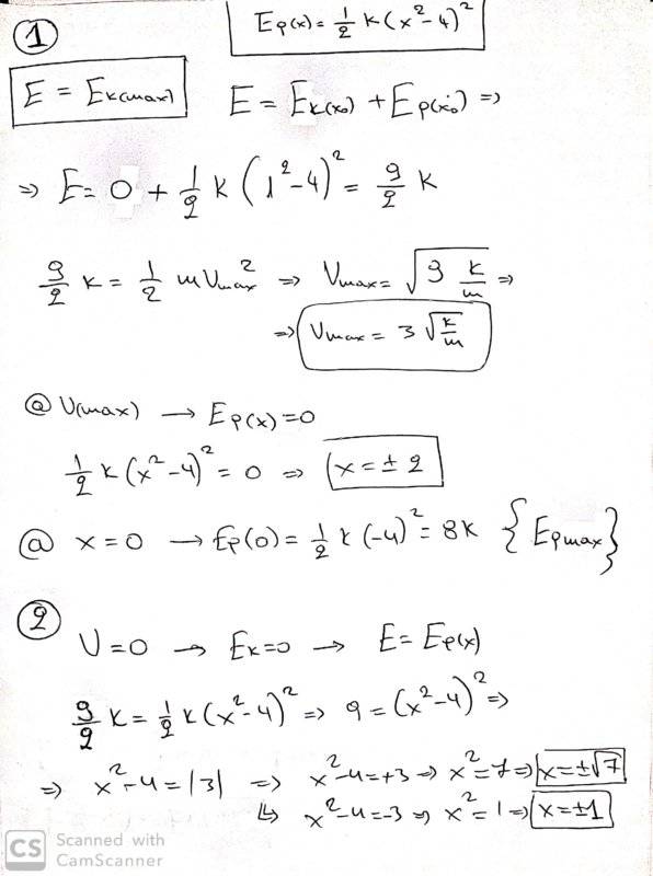

An object with m mass moving on x'x and Ep(x) = (1/2)*k*(x^2 - 4)^2 . x is the position of the object and k>0 (constant)
The object starts with zero velocity from x0=1
1) V(max) = ? and X @ V(max)
2) Which is the position speed will be zero again ?
nil
Hi !

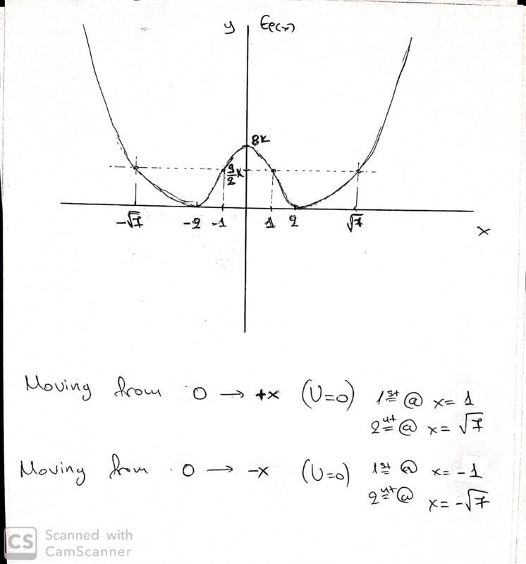

This is my try:
Is that correct ?
Thanks
Almost correct. All of your calculations are right, but you need to figure out which solutions for ##v=0## can actually happen. How much total energy would be required for the system to achieve ##x=0##? What would be the velocity at that point if the total energy is ##\frac 9 2 k##?
In addition to @tnich's observation, I have a minor comment. Your sketch is a little out of scale. Which two of the x positions 1, 2, √7 should be closest together?
