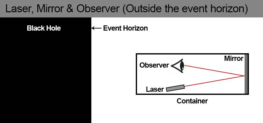

Scenario: Laser, Mirror and Observer.
An observer is sitting at the left side in a container which is heading left towards an event horizon.
The observer is holding a turned on laser pointer that is directed at a vertical mirror that is located at the right side of the container. The observer can thus observe the laser light since it is reflected by the mirror back towards the observer.
Picture 1. Laser, observer & mirror are outside the event horizon.
The observer observes the laser light reflected by the mirror.

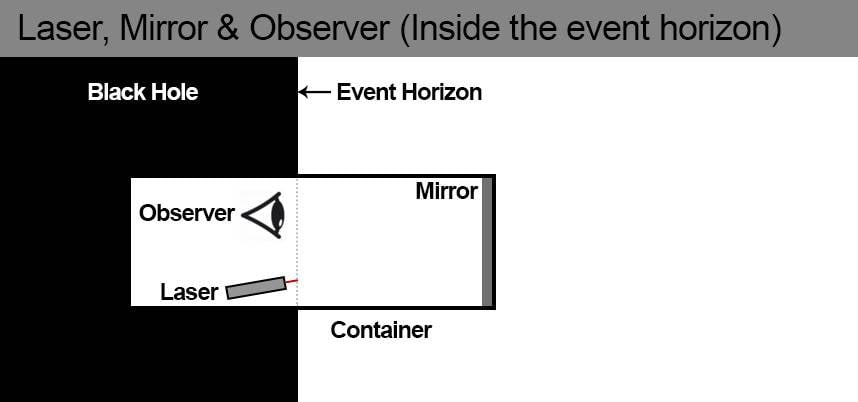

Picture 2. Laser & observer are inside the event horizon, mirror is still outside the event horizon.
As the observer and laser passes the event horizon, I am pretty sure that no more (new) light from the laser can reach the mirror and get reflected back to the observer. Thus it seems reasonable that the observer sees no more light. Now, of course light travels at c, so there may be a very brief moment the observer sees the remaining light after the laser passes the event horizon, but after this it seems to me the observer will not see any more light from the laser.
3. (no picture) Laser, observer & mirror are inside the event horizon.
As the right side of the container and thus the vertical mirror finally passes the event horizon, it seems to me that the observer will still not see any laser light, since the light going towards the right can't overcome the spacetime curvature.
Is this scenario reasonable, and if not, where am I thinking wrong?

No. You are making the same mistakes as in the previous thread.
Also, your diagrams are not correct, because the event horizon is not a spatial location. It's an outgoing light ray. There is *no* way to draw a proper diagram of your scenario in which it is "standing still". You need to be thinking of it as moving from left to right, relative to your container, with the speed of light. If you do that, you will see for yourself the proper resolution of your scenarios. This was already pointed out in the previous thread.

I also understand that things like these can't be easily pictured in 2D, but it was the best I could think of at the moment to illustrate my scenarios. I did the pictures as an illustration to help convey the idea of the scenarios. They were not intended to be exactly scientifically accurate.
