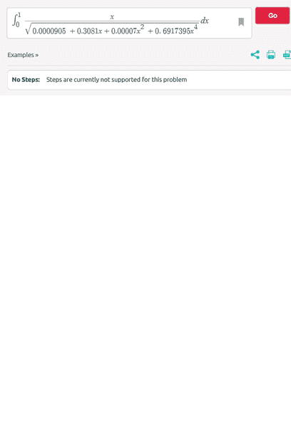

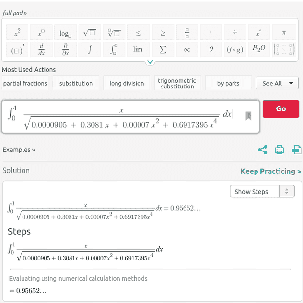

- TL;DR Summary
- I have been interested in finding a way to use an online integration tool to calculate the age of the universe. The answer I got is clearly wrong. I am hoping someone will be able to help me find my error.
The integration tool I am using is
https://www.symbolab.com/solver/definite-integral-calculator .
The following are the values of the five variables in the Friedmann equation with references of sources. I have also defined single letter variables I used for convenience.
http://www.thesuperspark.com/2015/07/age-of-universe-144-billion-years.html
J = 1/H_0 = 14.4 billion years.
https://astronomy.stackexchange.com/questions/19393/latest-cosmological-parameters
R = Omega_r = 0.0000905
https://www.cosmos.esa.int/documents/387566/387653/Planck_2018_results_L06.pdf page 33 eq 35
M = Omega_m = 0.3081
https://www.cosmos.esa.int/documents/387566/387653/Planck_2018_results_L06.pdf page 40 eq 47b
K = Omega_k = 0.00007
(Thanks to PeterDonis for pointing out my former page number error.)
L = Omega Lambda = 1 - Omega_r - Omega_m - Omega_k
The modified form below is based on the Friedmann equation integration:
https://en.wikipedia.org/wiki/Friedmann_equations#Detailed_derivation page .
t/J = t H_0 = INTEGRAL[0,1] (x (R + M x + K x^2 + L x^4)^-0.5) dx
This integral should result in a value close to 1, since t is the age of the universe, and the value of J=1/H_0 is close to (but not exactly equal to) this age.
The value of the calculated integral is 2.32613.
