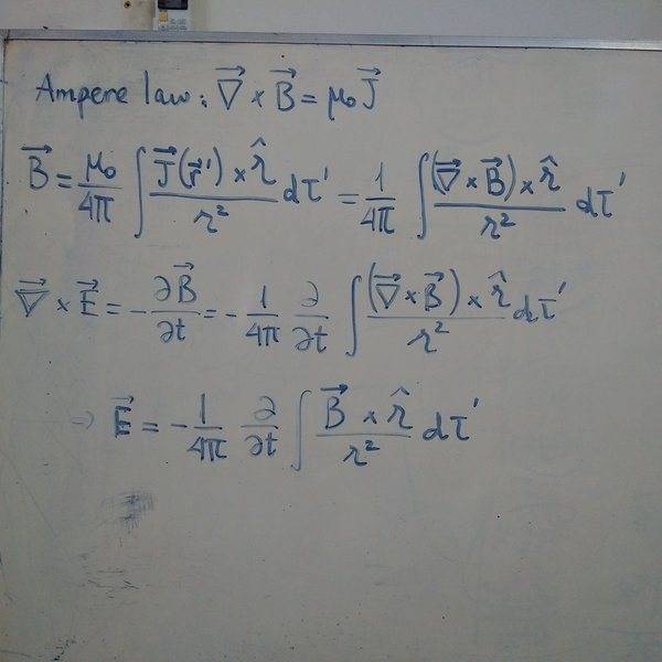

Hope it can help you :wink:

scoomer said:
On page 317 of "INTRODUCTION TO ELECTRODYNAMICS" 4th Ed. by Griffiths
I don't have the 4th edition. In the 3rd edition, your equation appears as part of Problem 7.47:
Use the analogy between Faraday's Law and Ampère's law, together with the Biot-Savart law, to show that <<your equation>> for Faraday-induced electric fields.
So if you assume the validity of Biot-Savart, you can start from there and use the similarity between Faraday and Ampère to suss out the analogous equation for ##\vec E##. Or you can look for a derivation of Biot-Savart from Maxwell's equations, and then adapt that to work for ##\vec E## instead of ##\vec B##, again using the similarities between the various Maxwell equations.
Likes scoomer and BvU
Thanks to Nguyen Son, Gene Naden and jtbell. Your responses are very helpful and much appreciated.
