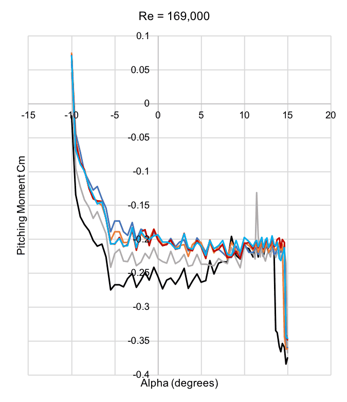

Hi guys, I hope everyone is safe and well.
I'm currently nearing the end of my third year dissertation, and I'm looking at analysing pitching moment coefficient (CM) data over a full range of angles of attack for airfoils with different serrations on the trailing edge. What are things to look for and what would, for instance, a lower value mean? I am aware that a CM of 0 is a symmetric airfoil and that negative is a nose-down moment etc. but I am unsure how to compare the results from different trailing edges to each other? Attached is one set of data, as an example.
Any and all help/insight is appreciated.
Likes FactChecker
Just a simple comparison, supposing that the lifts are equal, would say that the more negative pitching moment is a disadvantage since it would require more downward torque from the tail. The graphs you show seem strange to me. They change a lot at both AOA extremes and are flat or slightly increasing over most of the AOA range. That doesn't seem right. I would have expected a more linear, smooth downward slope.
