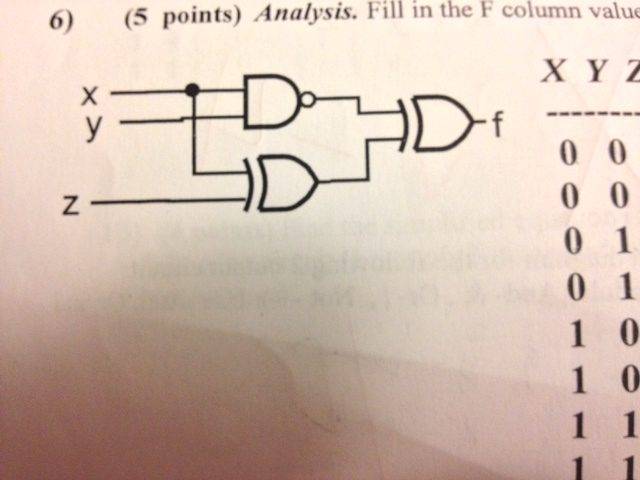

Fill in the F column values in the truth table for the circuit.
Need someone to check my work.
My Answer:
  • x y z | f | x! and y! | x! XOR z|
  • 0 0 0| 0 | 1 | 1
  • 0 0 1| 1 | 1 | 0
  • 0 1 0| 1 | 0 | 1
  • 0 1 1| 0 | 0 | 0
  • 1 0 0| 0 | 0 | 0
  • 1 0 1| 1 | 0 | 1
  • 1 1 0| 1 | 1 | 0
  • 1 1 1| 0 | 1 | 1

So, let's define the $\uparrow$ symbol as the Sheffer stroke, which corresponds to the NAND logic gate you have there. Then $f=(x \uparrow y) \oplus (x \oplus z)$. The truth table is then
\begin{array}{c|c|c|c|c|c}
x &y &z &x \uparrow y &x \oplus z &(x \uparrow y) \oplus (x \oplus z) \\ \hline
0 &0 &0 &1 &0 &1 \\
0 &0 &1 &1 &1 &0 \\
0 &1 &0 &1 &0 &1 \\
0 &1 &1 &1 &1 &0 \\
1 &0 &0 &1 &1 &0 \\
1 &0 &1 &1 &0 &1 \\
1 &1 &0 &0 &1 &1 \\
1 &1 &1 &0 &0 &0
\end{array}
Okay, I see where I went wrong. But you're saying x NAND y in the first row is 0 NAND 0 which is really 1 AND 1 = 1. I get that. Then you are saying in the 2nd row the same thing 0 NAND 0 = 1 because it's really 1 AND 1. Then in the 3rd row you are saying 0 NAND 1 which is really 1 AND 0 = 1. But how does that = 1? 1 AND 0 = 0. It only equals 1 if both are 1.
Actually not. The NAND operation means "not both". If I say $x \uparrow y$, or $x$ NAND $y$, that is equivalent to $\overline{xy}$. By DeMorgan, $ \overline{xy}= \bar{x}+ \bar{y}$, not $ \underbrace{\overline{xy}= \bar{x} \bar{y}}_{\text{Wrong!}}$.
Again, this reasoning is flawed. If you need to, calculate NAND's like this: to compute $x \uparrow y$, first compute $xy$, and then negate the result. You cannot compute NAND's by negating the $x$ and $y$ first, and then AND'ing the results.
Ahh! I see! So DeMorgans law changes the ANDing of xy to OR, while negating the terms as well. x! + y! ok. Going to re-work it and make sure I get the correct solution. I'll be back (Wait)
