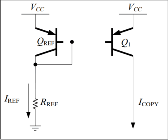

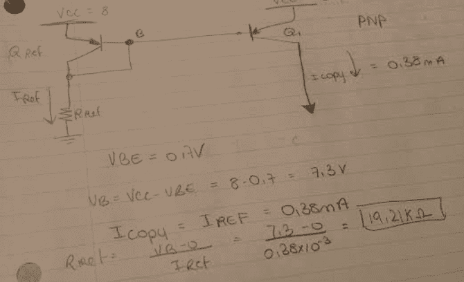

I am working on this problem. They start out by giving me:
I am asked to find Rref such that Vcc=8V and Icopy=0.38mA.
Transistor equations
In this case, they never specify if IB=0A (sometimes it does ?) but I would assume that it is and therefore beta would be very large and we ignore this.
Likes CWatters
That's the answer I got.
Likes Cocoleia
Right answer but you have the explanation backwards...
Beta is high so the base current is much smaller than the collector current. Therefore the base current can be ignored (but the base current isn't zero).
Likes Cocoleia and collinsmark
