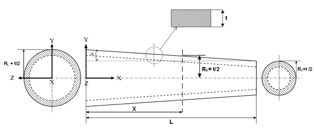

How to derive the formula to find the bending stiffness of an isotropic tapered tube which is cantilevered with a point load applied at the free end?

This is the model of the tube that I have. I need to derive a common formula in order to find the bending stiffness at different distances. say x=1,2,3..
At x = 0, let the external radius of the tube be RO and the internal radius be RI
For the values of RO and RI at a distance x from the fixed end then,
RO(x) = RO - x * tan α
RI (x) = RI - x * tan α
The second moment of area of the tube is then
I(x) = (π/4)*[RO(x)4 - RI(x)4]
and the bending stiffness = E I(x)
If you want to substitute the first expressions for RO(x) and RI(x) into I(x), well, it's probably a lot of algebra to clean up.
