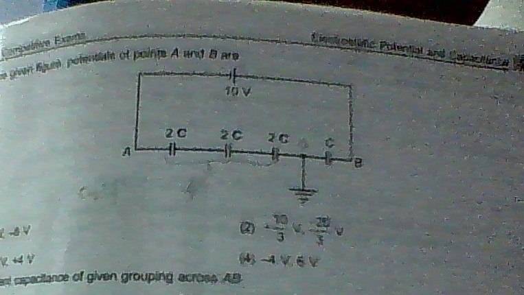

Find potential of A and B in the given figure. (pardon poor quality, I only have a webcam)
All related
marking 1 to 4 from left to right. C1,C2,C3 are in series. C123=(2/3)C. which is in parallel with C4. C effective is 5C/3. What now? I don't know what to make of the point between them (lets call it D) being earthed.
C1,2,3 are in series with each other and in series with C4.
What do you know about the current through components in series?
I understand C 1,2,3 are in series with each other but how are they in series with C4. Did you mean to say parallel, since they are connected across the same potentials of 10 and zero?
No I do mean series. For components to be in parallel they must share two nodes.
The equivalent capacitance of C1-3 is connected to Earth and the -ve of the battery.
C4 is connected to Earth and the +ve of the battery.
So they only share one node (earth).
Cwatters is trying to say that the current from the earthed point to the ground will always be zero, so essentially all the capacitors are in series.
BUT I have trouble myself understanding why that current will always be zero.
In order to make progress I'll give you two hints...
There is only one connection to Earth so no current flows through that connection to earth.
All 4 capacitors are in series with the battery so when the battery is connected the same amount of charge flows through all 4 capacitors. This continues until the sum of the voltages on each capacitor add up to the battery voltage (eg Kirchoff's voltage law).

current is same across series. Therefore charge on capacitors will be the same. Adding C 1,2,3,4 in series, equivalent capacitance is 2C/5, using Q=CV, total charge on each capacitor is 4C. Correct?
I don't know how to proceed further, shouldn't potential at A be 10 V itself since there is no capacitor till that point
Alright, so I know the potentials across each capacitor now. From 1 to 4 they are 2,2,2 and 4 V
How do I derive potentials at A and B from this?
I haven't checked the voltages you calculated but...
If the voltage across C4 is 4v and the left hand side is connected to Earth (0V) then the right hand side of C4 must be at -4V.
Edit: ok I agree your voltages are correct.

The answer says +4V, also at point A, the answer says the potential is -6V. This is just a mirror to what you said, though. Can you explain how you got this?
maybe we need to remind you that the potential difference across any type of lumped element between points A and B is ##V_{AB}=V_A-V_B## where ##V_A## and ##V_B## the potentials at points A and B respectively. So you know all the potential differences and also that the potential at the Earth point (lets name it C) is ##V_C=0##. You also know ##V_{BC}## for example, so...
Sorry I got the battery voltage wrong way around. Book answer is correct.
Do we consider the negative terminal of the battery at -10V?
since there seems a gradual increase to zero till the earthed point. and then again from 0 till +10 to the positive terminal
can you explain again why no current flows into the earth?

if you consider the negative terminal at -10V and the positive terminal at +10V then the potential difference across the source would be 10-(-10)=20V...
this seems counter-intuitive but undeniably correct. How can I easily understand that the sign of potential at A is negative, and at B is positive. You mention that we know potential at Earth is 0 and we got the potential differences correctly too. Then what's to stop the point at B from having a potential -4 V?
You can understand or infer that, all you can infer is because B is connected at the positive terminal will have a higher potential than A which is connected at the negative terminal, it might as well both potential be negative with ##V_B=-1V >-11V=V_A##, ##V_{BA}=V_B-V_A=-1-(-11)=+10V.##
Because it is ##V_{BC}=V_B-V_C=4V##

@CWatters I will also like to know that. I can ,sort of, rephrase the question , let's say that the voltage source in this example is 1000V that means that ##V_{BC}## will be 400V, so if we haven't earthed C point yet, and I go touch the C point, I will feel absolutely nothing, since the current through me will be zero?
The simple answer is no current flows in the Earth connection because it's not a complete circuit. There is no closed loop around which current can flow. In theory you could make a 1000v battery and hold onto the +ve terminal with one hand and Earth with the other. No current would flow because the -ve terminal of the battery isn't connected to anything.
The longer answer is yes you might feel it/get a shock. The reason is that in the real world there can be some parasitic capacitance between the circuit and Earth that completes the loop. This capacitance isn't shown on the circuit diagram and is typically quite small. It's this capacitance that could discharge through you giving you a shock.
