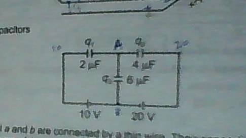

Find charge on 3 capacitors.
Join two squares with one common side. At the middle of the common edge, place C3=6uF (micro-farad).
On upper edge of left square, place C1=2uF. On upper edge of right square place C2=4uF. On lower edge of left square, a battery-10V and on lower edge of right square 20 V
Photo attached, but quality of camera is not really good.
1)sum of capacitance=equivalent C when in parallel.
2)reciprocal addition when in series
3) all other related to capacitance
This is the first time I've encountered multiple batteries in a circuit. Note-Current electricity is the next chapter in our textbook, so I'm not very familiar with Kirchhoff's laws etc. i.e. just the basics.
My intuition was that either two currents will flow from both or a single one from 20 V to to 10 V, how can I know for sure?
I'd greatly appreciate some help, thank you

Instead of this description, a circuit diagram would be much more helpful, for you and for the helpers. It is going to be difficult for the helpers to explain and take you through the solution without a diagram. You can post the diagram using the UPLOAD button below the text-editor.

Alright. I was avoiding a picture due to my poor webcam quality. I'll write out my intuitions in attempt at a solution and post a picture. Thank you.

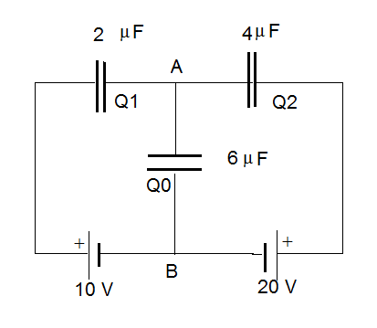

You certainly have some drawing program on your computer, Paint, for example. Make a drawing, copy, and paste it into your post, like I did :
That's a really good idea! I'll do that from next time. Thanks a lot for drawing this :D

You said Kirchoff's laws are in the next chapter of your textbook, I have big trouble understanding how we can solve this without using Kirchoff's laws.
Using kirchhoffs laws ,specifically KVL, you can make one equation for the closed loop that contains C1, C0 and 10V, another equation from the closed loop that contains C2,C0 and 20V, and the third equation will come from KCL and will be an equation between the charges on the capacitors Q0,Q1 and Q2.

Kirchhoff's Laws refer to voltages and currents, but you can apply more basic rules here: The definition of voltage between two points as the work done by the electric field between those points, and as work, it is additive.
The other basic law is that charge can not be created or destroyed. If three capacitor plates are connected, and no charge was given to the junction, the net charge on the plates remains zero. Kirchhoff's Laws follow from these more basic Laws, + Ohm's Law.
