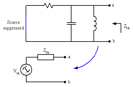

It would be the potential across the points a-b, which is also the potential across the inductor, which is also the potential across the capacitor; The inductor and capacitor are in parallel so they must share the same potential difference.
After the voltage drop I want to 'turn off' the source, so I'd neglect the voltage source and then calculate the impedance through the resistor and capacitor? Or all three components would be involved?
All three are involved. To suppress a voltage source you replace it with a short circuit (a wire). To suppress a current source you replace it with an open circuit (remove the component completely).

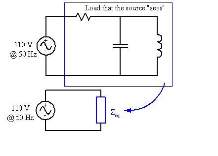

Nope, because the equivalent impedance of the network is the net load that the source sees.
whereas, the Thevenin impedance is the equivalent "source" impedance that a load connected across terminals a-b would see.
According to your latest attachment, part (a) of the question addresses the Thevenin Equivalent Impedance of the circuit, where the output of the circuit is taken to be at terminals a and b. So the diagram immediately above suits that.
