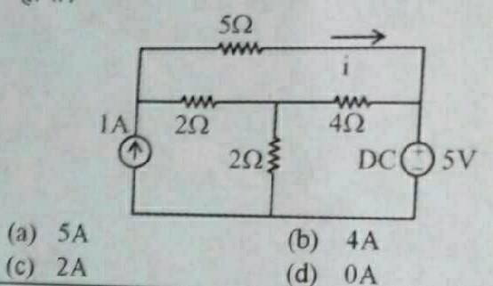

Q . Find current i through the 5Ω resistor ?
I would like to understand what does leftmost 1A represent . I haven't seen something like that before in my book . Is it a Galvanometer or something else ?
It is a current source.
Likes Jahnavi
OK .
I am getting option d) i = 0 . Is that correct ?
Jahnavi said:
OK .
You'll have to show the details of your work. We won't just confirm or deny what could potentially be a guess :smile:
Jahnavi said:
OK .
That is correct.
Btw, you can check it yourself using node voltage method and KCL.
Likes Jahnavi
I did use KCL and KVL to arrive at the result .Using the current source and KCL , I assigned current in all the resistors . Then I wrote 2 KVL eqns. for the upper and bottom right loop .
Thanks a lot :smile:
Well done!
I myself prefer the node voltage method to avoid any silly mistakes while writing KVL.
Likes Jahnavi
