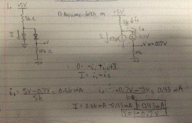

The problem is pretty straightforward but the format of the circuit is confusing to me so I'm not sure if I'm doing it correctly. Could someone please check my answers? Just concerned with part (a) for now:
(a)
You might want to recheck your value for V. Note that the top of the first diode is at +0.7V, while the V terminal is just after the second diode which provides a 0.7V potential drop...

Thanks, that's exactly what I wasn't sure about. So if the voltage at the node connecting the diodes is 0.7V, I would need to "step down" 0.7V to get to the V terminal right? So the voltage at V is 0 V?
Also, aside from the wrong V value, is the method I used to solve for the currents correct?

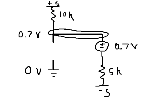

I was under the impression that it'd be something like this:
Even though the diode's off I thought the anode's voltage would still be 0.7 V because of the other diode's anode, and its cathode would be 0 V because of the ground. If this isn't correct what would it be?
With diode 1 out of the picture because it's assumed to be off (reverse biased), it's anode voltage cannot be presumed to be 0.7V. It will depend upon the potential drop from +5V that occurs across the 10k resistance. We can only presume that it will turn out to be less than 0.7V (and thus verify our assumption about D1 being off).
The way to proceed is to determine the potential there by further analysis. Write a node equation for that node assuming that D1 is off and D1 on. Solve for the node voltage.

Doing node voltage analysis at the anode:
(Vn-5)/10k + (Vn-0.7)/5k = 0
I get the voltage at the node, Vn = 2.133 V. This isn't less than 0.7 V though, did I do the analysis incorrectly?

Nope. You've missed out the -5V source in the second term.

Hm okay if I move the 0.7 V source below that 5k resistor, would I need to "step up" by 0.7 V from the -5 V source?
So:
(Vn-5)/10k + (Vn-(-5+0.7))/5k = 0
(Vn-5)/10k + (Vn+4.3)/5k = 0
Vn = -1.2 V
Yup.
Your picture is correct.
So now you can ignore diode 1, right?
So now, what's the voltage across the two resistors? The current? Then, what is the cathode voltage, considering the 5K resistor goes to -5V?

Think I got it now. The current through the 2nd diode is 0.62 mA, and the cathode voltage of the 2nd diode is -1.2 - 0.7 = -1.9 V. (Solved for the anode voltage above).
You got it 100%!
You could also have gone
i = 0.62 mA
therefore. drop across the 5K is 0.62mA*5K = 3.1V
but the bottom of the 5K is at -5V
so the top must be at 3.1 - 5 = -1.9V.
