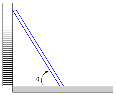

Analyzing Forces and Torque of a Slipping Rod
In summary: I find this hard to interpret.At a reasonable angle theta, such that the rod is on the brink of slipping, a_CMy is pretty big and a_CMx is pretty small. But there is not enough force on the wall to stop the rod from rotating, right? I need some knowledge of the forces that comes from the fact that the rod is rotating to relate a_CM with my initial quantities.In summary, the problem involves a rod with uniform mass and an initial angle theta with respect to the ground. It is assumed that there is no dynamic friction and the rod has no acceleration in the X direction. The moment of inertia is useful in this case, and equations are used to analyze the forces and torque. However, it
powerof
43
[/B]
As a diagram any of the countless images on the internet serve well:
Suppose the static friction was not sufficient to maintain the rod in a static equilibrium and it starts slipping/sliding. It has an initial angle theta with respect to the ground. Assume there is no dynamic friction and that the rod has uniform mass. The rod has a length L. With what velocity will it's center of mass hit the ground?
The moment of inertia is useful in this case: [itex]I^*=\frac{1}{12}MR^2[/itex]
[itex]\tau_{total} = I^* \alpha [/itex]
[/B]
I tried analyzing the forces and then looking at the torque as well.
Y axis (positive up).
[itex]N_{ground}-Mg=Ma_{CM_{y}} \Rightarrow N_{ground} = M(g+a_{CM_{y}})[/itex]
X axis (positive right).
[itex]N_{wall}=Ma_{CM_{x}}[/itex]
Torques with respect to the center of mass (positive counterclockwise, or "out of the screen"):
[itex]\tau_{total} = I^* \alpha = N_{ground}\frac{L}{2}cos\theta - N_{wall}\frac{L}{2}sin\theta = \frac{1}{12}ML^2\alpha[/itex]
[itex] M(g+a_{CM_{y}})\frac{L}{2}cos\theta - Ma_{CM_{x}}\frac{L}{2}sin\theta = \frac{1}{12}ML^2\alpha[/itex] //substituted the normal forces
[itex] (g+a_{CM_{y}})cos\theta - a_{CM_{x}}sin\theta = \frac{1}{3}\frac{L}{2}\alpha = \frac{1}{3} (a)_{t}[/itex] //a_{t} is the acceleration of a point at the end of the rod in the same direction as the same point's velocity
I'm more or less stuck here. How can I relate the velocity of the center of mass with something I know?
Thank you for your time.

Consider the locations of the mass centre and the two endpoints as vectors. What equation relates them?

You need to be careful not to make unwarranted assumptions in the equations. This is quite a tricky question. Bear in mind that the normal forces cannot go negative.

I was thinking in terms of an arbitrary origin. If ##\vec{x_a}##, ##\vec{x_{cm}}##, ##\vec{x_b}##, are the three vectors, what equation relates them? What do you get by differentiating that twice?

A bit of both. Normal forces from one-sided contacts cannot go negative. This puts constraints on the applicability of your equations. You need to consider whether blindly following your equations to the point where the rod is flat on the ground will lead through a domain which violates this.
To cover that, try to find out whether at some point a normal force can become zero.

I can try looking at the formulas:
[itex]N_{ground} = M(g+a_{CM_{y}})[/itex]
g is a positive quantity given my sign convention, therefore the normal with the ground would become zero if a_CMy, which is negative given my sign convention again, would be greater than g in modulus. But I find this bizarre, how can an object fall faster than gravity pulls it if no other force is pushing it down?
This would be negative only if a_CMx would be negative since mass is positive. That would mean the rod would be going upwards (left actually, but it can't penetrate the wall), tending to kiss the wall. I find this ridiculous, so in this context N_wall is always positive except when a_CMx is 0, which would correspond to the object at rest on the ground.

A negative x-component of acceleration of the CM does not imply that the CM is moving toward the left.

The rod can lose contact with the wall. You can see if you do some little experiment with a pen and a book, for example. At the end, the pencil loses contact and slides on the ground.
After detaching from the wall , Nwall =0, and aCMx =0. That means the velocity of the CM has a constant horizontal component.
The rod is in contact both with the wall and the ground initially, and for some time after it. Solve the motion of the rod and see, at what position become one of the normal forces equal to zero.

Your equations are valid initially. From them you can calculate the angle at which the normal force from the wall becomes zero. You can use your equations to determine the complete circumstances at that point: the linear and angular moments and the position.
From that point you can then apply different equations. As ehild mentions, the horizontal component of the velocity of the mass centre will now be constant, so you only have to consider the vertical velocity and the rotation.
The next question is whether it ever loses contact with the ground. If it does the question becomes unanswerable without making assumptions about elasticity. If there's any elasticity, the mass centre only reaches the ground in the limit, and will have zero vertical velocity. At that point we could conclude that the question setter blundered.

I don't know where to start when analyzing the general motion of the rod. For the moment I'll just try to set N_wall=0 and see what comes out.
[itex](Ma+Mg)\frac{L}{2}cos\theta = \frac{1}{12}ML^2\alpha[/itex] //cancelled the second term since N_wall is null and substituted N_ground with its value; note that since a_CMx is null then a_CMy=a_CM=a
[itex](a+g)cos\theta = \frac{1}{3}(\frac{L}{2}\alpha)=\frac{1}{3}a^*[/itex] // a is the acceleration of the CM, vertical only since a_CMx is zero
Using the relation between CM and and object described with respect to the CM hinted at by another poster, we can get the following, where I have taken a_p to be the acceleration of the point in contact with the ground (since it's in contact with the ground it only has a horizontal component) which equals the acceleration of the CM plus the acceleration of the point with respect to the CM:
[itex]\vec{a_p} = \vec{a} + \vec{a^*} \rightarrow a_{p}\vec{i} = a\vec{j}+a^*\vec{u}[/itex] //u unitary vector in the direction of a*, which is perpendicular to the rod
[itex]a_{p}\vec{i} = a\vec{j}+\frac{L}{2}\alpha (\sin\theta \vec{i}+\cos\theta\vec{j})[/itex] this equality holds only if the components of the vectors are equal which gives the following system
[itex]a_{p}=\frac{L}{2}\alpha\sin\theta[/itex]
[itex]0=a+\frac{L}{2}\alpha\cos\theta[/itex]
If I did all the previous steps correctly (which admittedly is a big if), then by dividing the two equations I get the following relation between the acceleration of the center of mass (vertical) and the acceleration of the point of contact (horizontal) but I don't feel it's very useful because I get the angle as a function of something I don't know:
[itex]\tan\theta=-\frac{a_{p}}{a}[/itex]

Up until the point where it loses contact with the wall, geometry gives you the relationship between linear velocities and angular velocity. A conservation law relates those to the angle at that point. This will be much easier than solving differential equations.
Having done that, you can derive the equation for the normal force from the wall at any given angle and deduce the angle at which that force becomes zero.

Using geometry as you said I get that the distance of the center of mass to the point O, which I take to be the corner formed between the wall and the ground, is constant, independent of the angle and even more, that distance is half the length of the rod, that is, L/2. The center of mass then, while the rod is touching the wall, follows a circular path around O. I will denote by lowercase L the distance from O to CM, that is, L/2=l.
[itex]\vec{x_{cm}}=l\cos\theta\vec{i}+l\sin\theta\vec{j}[/itex] //we take O to be the origin
[itex]\vec{v_{cm}}=-l\dot{\theta}\sin\theta\vec{i}+l\dot{\theta}\cos\theta\vec{j}[/itex]
[itex]\vec{a_{cm}}=-l\dot{\theta}^{2}(\cos\theta\vec{i}+\sin\theta\vec{j})=-l\omega^{2}\vec{x_{cm}}=-\frac{l^2}{l}\omega^{2}\vec{x_{cm}}=-\frac{v_{lineal}^{2}}{l}\vec{x_{cm}}[/itex]
[itex]v_{lineal}^2=v_{cm_y}^2+v_{cm_x}^2[/itex]
Note that ##\theta(t)## doesn't necessarily grow linearly with time.

OK. You can get a useful result from this by considering the ##\hat{j}## component. Llikewise, you can get another useful result by setting up a similar equation for the point of contact with the wall and considering the ##\hat{i}## component. Clearly, this result will only be valid as long as the rod is in contact with the wall. It might be a good idea to express ##v_{lineal}## in terms of the angular velocity ##\omega## of the rod.
You can get these same results in a direct manner by following ehild's suggestion of writing ##x_{cm}## and ##y_{cm}## in terms of ##\theta## and taking time derivatives.

You need to find out the velocities at the point where the rod leaves the wall. From there you can apply a different set of equations for the subsequent movement.
