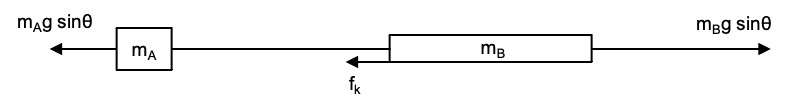

This situation is a variant of the inclined Atwood machine with friction present. Because the pulley is ideal, the tension on the two string segments is the same. We can consider the FBD of the two-mass plus rope system in which the external forces acting on the system are
  1. ##m_A~f\sin\theta~## acting on ##m_A## down the incline
  2. ##m_B~f\sin\theta~## acting on ##m_B## down the incline
  3. ##f_k=\mu_{\text{AB}}(m_A+m_B)g\cos\!\theta~## acting on ##m_B## parallel to the incline
This is a one-dimensional problem as far as the kinematics are concerned. We can straighten the string to a straight line and rotate the whole thing by ##\theta## to get the equivalent FBD shown below
Here is why I drew the friction to the left, in the same direction as the tension on ##m_B##. Say friction and gravity can be turned on and off at will. Initially they are both off and the system, we are told, is at rest.
  1. If we only turn on gravity, the system will accelerate to the right.
  2. If we only turn on friction the system will remain at rest.
  3. As mentioned above by @Orodruin in #20, if we turn on both friction and gravity, the system cannot possibly accelerate to the left. If it did, then statement 1 would be violated when we trun the friction back down to zero.
Note that the FBD above affords easy calculation of the magnitude of the common acceleration. Knowing that, one can easily sort out the internal forces from FBDs of the individual masses.
kuruman said:
We can straighten the string to a straight line and rotate the whole thing by θ to get the equivalent FBD shown below
There is also friction between the blocks. This of course represents a 3rd law pair but once you straighten the string they act in the same direction because one is turned 180 degrees.
Yes, of course, this makes much more sense. I assumed without thinking that the frictions would cancel like the tensions although it didn't sit well with me because of what happens when the incline is frictionless but there is friction between blocks. My excuse of the day is that my wife was pressuring me to do something for her so I posted in a hurry.
