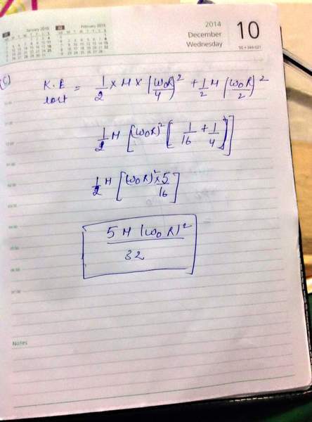

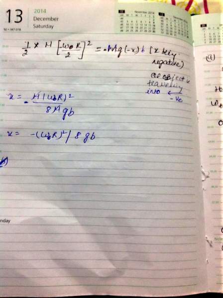

I calculated those last questions I got them as
X= -(wR)^2/8gb
V of centre of mass as 0 since it come to halt
And Ke total as 5M(wR)^2/32
are these correct ?
are these correct ?
For question C, it's not clear where we're measuring the distance from. Is it from the starting position or from the point where forward motion ceased? Either way, I don't get your answer. Pls post your working.
(Consider how the force and torque during this phase compare with those during the first phase.)
Calculated results
Here it goes
No, that's wrong. Reread my post #10 very carefully. The distance you have calculated is the relative movement between the two surfaces. This is much greater than the distance the disk moves horizontally.
I suggest it will be less confusing to work with torques, accelerations etc. rather than with energy.
Btw, I believe the question to be wrong in part C. I do not see how it can be true that the disk will stop rotating. It is a mistake to assume that it will continue to slip until it comes to a complete rest. At some point it will start to roll, not slip.
