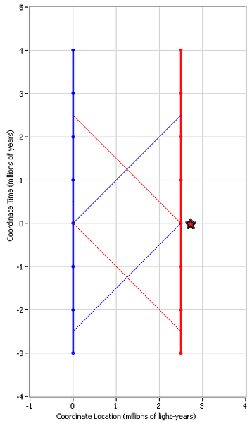

(I have to point out that you haven't yet done the thing that I asked you to do back in post #5 - be as rigorous as possible about defining what you mean by "before" and "after", "past" and "future".)
Whether the motion is towards the Andromeda galaxy or away from it is irrelevant, and this really is a basic relativity of simultaneity situation. It's only startling because we've taken the very small RoS effect between two observers moving at walking speed (about 10-9 the speed of light) relative to one another and then multiplied that effect by the enormous distance to the Andromeda galaxy to get a startling large effect.
An easy way of seeing this is to take the coordinates of the event (t=0, x=2.5 million light years; invasion fleet takes off) according to one of the two earthbound observers and use the Lorentz transforms to calculate the coordinates of this event for the other observer. Assume that the two observers are walking in opposite directions down the street, and choose the coordinates of their meeting to be (0,0) for both. You'll discover that they have a very different notion of which events in the Andromeda galaxy are simultaneous with their meeting in the middle of the street.
And what does that mean?
Mfb already answered that question back in post #2: "It just tells you that it is pointless to talk about what happens today (literally, not yesterday and not tomorrow) in other galaxies".
The only thing I'd add to his answer is that you've been tossing around the words "past" and "future" without thinking enough about what they mean. When I say "the fleet took off in the Andromeda galaxy at noon" I'm really saying "the fleet took off in the Andromeda galaxy at the same time (there's that RoS thing again!) that my wristwatch on Earth read noon". How much metaphysical significance can I attach to the fact that someone else says "when the fleet took off from the Andromeda galaxy my wristwatch didn't read noon"?
The physical meaning of the statement "X happened before Y" is that a cause at X could in principle create an effect at Y. That's a real statement about real physical effects, and viewed that way there's no paradox in the Andromeda Paradox. It's only when you start making assumptions about how comparing wristwatches on a street on Earth might correlate to events in the Andromeda galaxy that cannot even be observed for 2.5 milion years that you can find a paradox - and the resolution is to challenge those assumptions.

Good idea. Here's a bunch.
Let's start with the Inertial Reference Frame (IRF) in which the blue earth, at the spatial origin and the red Andromeda galaxy, 2.5 million light years away, are mutually at rest. The dots mark off millions of years of Proper Time for both the Earth and the galaxy.
Since the entire galaxy can't explode, we'll have a single star explode as a super nova at time zero in this IRF which will be visible on Earth 2.5 million years later as depicted by the upper thin red line. At time zero, earthlings can see the galaxy as it was 2.5 million years earlier as depicted by the lower thin red line. Similarly, Andromedians can see Earth as it was 2.5 million years earlier as depicted by the lower thin blue line and it will take another 2.5 million years before they can see earthlings as they are at time zero, as depicted by the upper thin blue line. This is all pretty simple and basic, don't you agree?
Now we can transform the entire diagram for this IRF into one that is moving at 0.4c relative to the original one:
In this IRF, the Andromeda galaxy is a little closer to the earth, 2.3 instead of 2.5 million light years away, and at Coordinate Time of zero, Andromeda is 1 million years later in Proper Time from when the supernova exploded. This means that the supernova exploded about 1.1 million years earlier of Coordinate Time than in the original IRF. But nothing changes as far as anything that anybody can see, measure or observe. Note that it will still take us another 2.5 million years of our Proper Time before we can see the supernova on earth. Same thing with all the other times mentioned before.
Now we can transform to the diagram for the IRF moving at 0.4c in the other direction with respect to the original IRF:
Now at Coordinate Time zero, the supernova has not yet exploded, it will take another 1.1 million years of Coordinate Time later. Once again, you should confirm that all observers see the same thing as depicted in this IRF as they do in the other two IRFs.
Have all the paradoxes vanished so far? In the next post, I'm going to show some more diagrams with an observer traveling from Earth to Andromeda.
