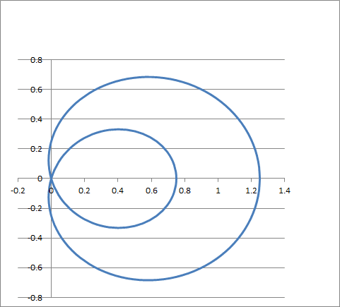

How can we find the angle at which the curve of equation : r=b + acosθ hits the x-axis.
I want a fast way or method since I only need it to plot the graph well. I'm only asked to plot the curve well and pay attention to the angle at which the curve hits the x-axis and not to calculate and write how I got it.

Fair enough.
So what you want is ##\displaystyle {dy\over dx}## at y = 0, right ?
Write ##\ y = y(r,\theta) = y(\theta)\ ## and ##\ x = x(r,\theta) = x(\theta)\ ##
Take derivatives
Divide
On the way you see you need derivatives at ##\theta = 0, \ \theta = \pi## that are trivial.
The other two or four (at ##x=0## ) require some work.
I know of no quicker way.
(except using excel to cheat drawing the pictures :wink:)
