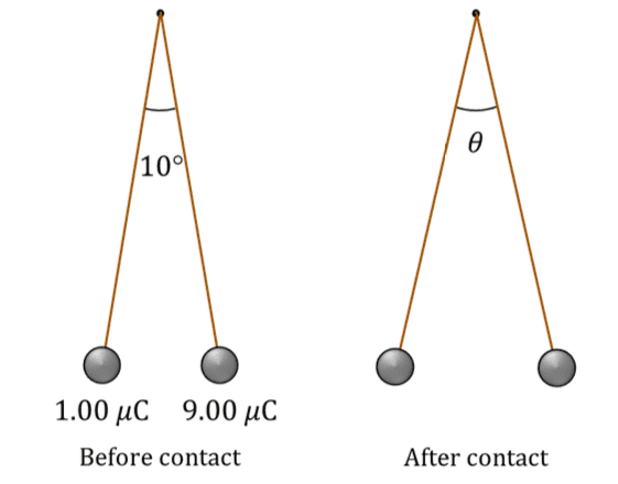

Two positively charged metal spheres are suspended from the same hook by light strings of equal length, making an angle of 10.0◦ with each other. The charges carried by the spheres are as shown in the diagram. After that, the spheres are brought in contact briefly, then released. If the mass of each sphere is 4.00 g, calculate:
a. the length of each string.
b. the new angle θ between the two strings.
Diagram is attached.
I've solved part (a) of the question by using the net forces in the horizontal and vertical directions. I found L to be 27.88m. I am completely lost on part (b). How can I approach this question?

Bringing them into contact will equalise the charge between them*, so that each has ##5\mu C##. Taking that into account, can you solve part (b)?

Ok so with that info, I can get the electric force on each sphere just after they come into contact. But I'm still lost on how I can go from there to knowing how far the spheres separated to determine that angle. Would the change in energy approach work here?
Just use the same approach as you used for part (a). In that case you would have derived an equation relating the two charges, the angle and the string length, with the string length L being unknown. Now that you know L, can't you just use the same equation with the charges each being ##5\mu C## and the angle being the unknown?

Ok so for part (a) here's what I did:
For the left sphere, Fnetx = Ftsinθ - Fe ⇒ Fe=Ftsinθ
Fnety = Ftcosθ - Fg ⇒ Ft = Fg/cosθ
From these 2 equations, derive that Fe = Fgtanθ
Fe= kq1q2/r^2 = Fgtanθ
isolate r⇒ r = √(kq1q2/Fe)
In the triangle of spheres hanging, θ is the angle that the string on one side has with the vertical. r is separation distance of spheres. L = r/(2sinθ)
Therefore, L = √(kq1q2/Fe)/(2sinθ)
That is how I did part (a).

That equation relates the variables ##L, q_1,q_2, F_e,\theta##. In (b) you know the values of all those variables except ##\theta##. So make ##\theta## the subject of the equation, substitute the values in (b) for the other variables and you can calculate ##\theta##. Then you need to double it to get the answer to (b) because the ##\theta## in the question is the whole separation angle, whereas yours is half that angle (it would have been better to use a different letter for the half angle, to avoid this confusion).

So in that situation, I don't know what Fe (electric force) is when the 2 spheres are separated by that given angle, and I cannot determine that without knowing the separation distance. How can I work around this?

So take the angle and distance to be unknowns and use the geometry to write an equation relating them.

I already did that in a previous step, in part (a) when I determined string length where L = r/(2sinθ). This is an equation that relates the angle and separation distance, and using this, I was able to get to the equation L = √(kq1q2/Fe)/(2sinθ). So I still have unknowns other than the angle, preventing me from being able to determine the angle. What could be another way to do this?

Yes you do. In post 7 you wrote a formula for Fe in terms of ##\theta## and Fg. So substitute that formula for Fe into your equation and then you'll have an equation in which the only unknown is ##\theta##.

But in that case the spheres are in equilibrium so we know that Fnet = 0, which let me arrive at that equation that relates Fe and Fg. The question just says they're released after being in contact, and doesn't say the balls have reached static equilibrium. So how's it possible to use that equation again here?

Okay so you're suggesting I should just assume its gone back to being in static equilibrium and just apply the same equations from part (a)?

Yes.

Okay so in part (a) I had these equations: Fe=Fgtanθ=mgtanθ and L = r/(2sinθ). If I plugged in r = √(kq1q2/Fe) in L = r/(2sinθ) I would have L = √(kq1q2/Fe)/(2sinθ). Plugging in Fe=Fgtanθ=mgtanθ into that equation would yield L = √(kq1q2/(mgtanθ))/(2sinθ). So in this equation I have everything needed but when I isolate for θ I get 2 trig quantities so I ended up with ((sinθ)^2)tanθ = kq1q2/(4L^2 *mg). How can I solve for θ here when I have both sinθ and tanθ in the equation?
There's no easily apparent route to an analytic solution, but we have numeric values for all the other variables, so we can just use a numeric equation solver, like Wolfram Alpha, to find the value of theta.

You can probably get a decent approximation by replacing both sin(θ) and tan(θ) with θ (in radians).
