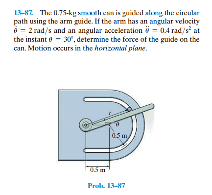

The 0.75-kg smooth can is guided along the circular
path using the arm guide. If the arm has an angular velocity ##\theta^. = 2rad/s## and an angular acceleartion of 0.4 rad/s^2 at the instant ##\theta = 30degrees##, determine the force of the guide on the can. Motion occurs in the horizontal plane.
cylindrical stuff

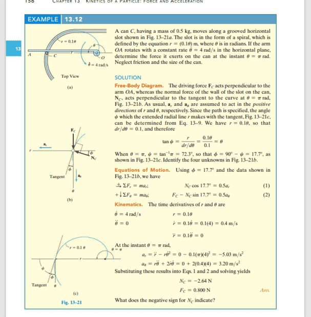

so I was wondering. there is this normal force on the can from the path. And there's this formula to find the angle between the radial line and the tangent or also between the normal force and either the radial or theta axis. the formula is ##\psi = r/dr/d\theta##. The thing is that here they have just used ##\theta = 30degrees## for some reason and I can't quite see why they use 30 degrees as being the angle between the axis and the normal force instead of the psi angle. Could someone clarify this please?
Thanks in advance.
for more clarity:
here, 30 degrees is used, but why is that?

because the net force you have labeled as ##N## (without friction) always acts toward the paths center.

for the circular arc the normal force from the guide path is directed toward the center of the path ( ie the center of the circle - not the center of the pin for the arm ). It must be normal to the tangent at the point of interest.

yes yes of coursre that I know, and that is why I am asking why I can't use the formula to determine the angle between the radial line r shown and the normal force. Instead they use 30 degrees here, but how do you determine that?
I'm sorry I don't think I understand your question. They are telling you its 30 deg ( ## \theta = 30^{\circ} ## ) at the instant shown. Because there is no friction ( and its an isosceles triangle), that angle between ##r## and ##N## must be ##\theta##.

well, so if you look at this example the angle psi, the formula I mentioned above is used for the normal force angle.
I believe you can use it?

Its says this is in the horizontal plane, so this is a top view (gravity is acting into the page)
oh, that is what they mean.., okay thanks a lot. I thought that it was downwards or something.

Whats your equation for ##r(\theta)##?
Likes simphys
##r = cos(\theta)## and for the given, r = 0.866 and for rdot --> ##rdot = sin(\theta) * \theta(dot)## = -1
$$ \frac{dr}{d \theta} \neq \dot r $$
Likes simphys
how come is it not?
oh dear......
simphys said:
how come is it not?
becuase ## \dot r = \frac{dr}{dt}##
I get - 60 degrees which indeed makes it 30 degrees now..... thanks a lot!! Need to watch out on those two mistakes I just made here.
