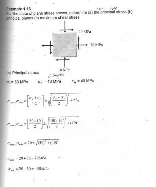

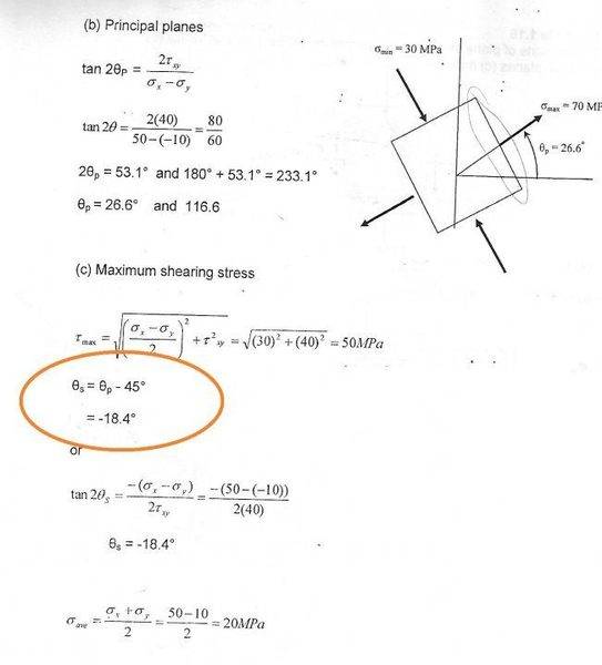

I know that an element that is subjected to max shear stress is 45 degree away from position of an element that is subjected to principal stress.I couldn't understand why the θ s= θ p -45 degree?
Cant it be θ s= θ p +45 degree ?
IMO, it can be both θ s= θ p -45 degree and θ s= θ p +45 degree [/B]
or i miss out something ?
anybody here ?
