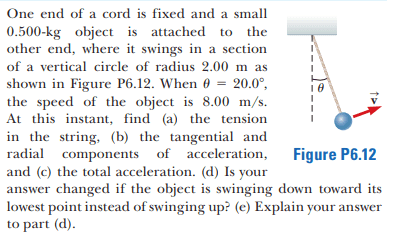

For (c),

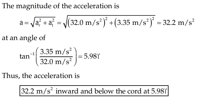

Solution is
Can someone please explain how they calculated that angle? I thought they would do ##arc\tan (\frac {32}{3.35})##
Many thanks!

##\tan^{-1}## is one way of writing ##\arctan##.
Or is it the 3.35/32 instead of the other way up that bothers you?

The OP seems to be unaware that the trig function inverses can be written in two ways: e.g., ##\tan^{-1}(x)## is the same as arctan(x), and similar for the other circular trig functions.
On another note, does anyone recognize the symbol that follows 5.98 in the solution? Evidently it means "degrees" since ##\tan^{-1}(\frac{3.35}{32.0}) \approx 5.98## (degrees), but the symbol used looks like ##\gamma## to me, which I've never seen used to signify degrees .

Thank you for your reply @haruspex!
Sorry I should been more accurate - it is the 3.35/32 that is bothering me

Sorry I was actually aware that ##tan^{-1} = arctan##. However, I was not sure why they wrote 3.35\32 instead 32\3.35 inside the tan function.
Also yeah that textbook solutions dose use the gamma symbol for degrees for some reason.

The 32 acceleration is radial. The angle quoted is that between the radial acceleration and the total acceleration. The cosine of that angle would be radial/total and its tangent is tangential/radial.

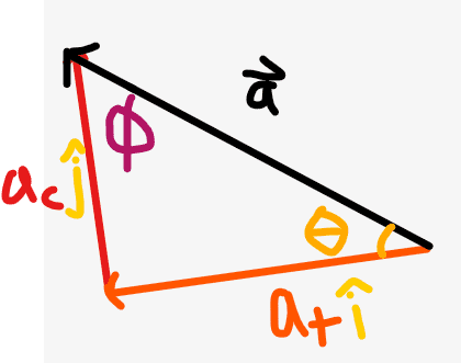

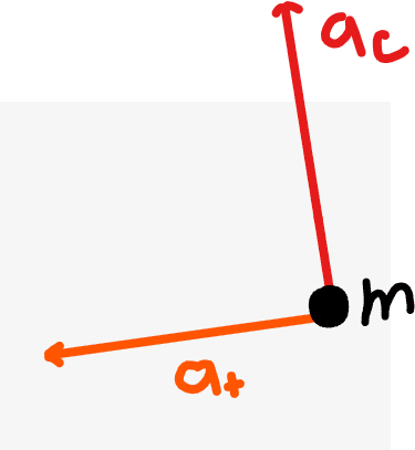

When I draw a diagram of the accelerations acting on the mass when ##\theta = 20~degrees##
Then draw a vector addition diagram to get the total acceleration,
I see that ##\tan\theta = \frac{a_c}{a_t} = \frac{32}{3.35}##

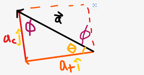

I know this is bad practice to change symbols when solving a problem, but if I add an angle phi (use to represent tangent/radial acceleration) ,
Then I can see that ##\tan\phi = \frac{a_t}{a_c}##. I think I'm now not sure how they got acceleration to be below the cord at 5.89 degrees.

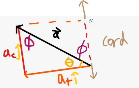

The angle of a line "below the cord" means the angle between the cord and the line, measured on the underside of the cord. In your last diagram above, that is the angle between the pale brown cord and the black total acceleration vector, measured anticlockwise from the cord.

Oh thank you for your help @haruspex! I see it now :)
