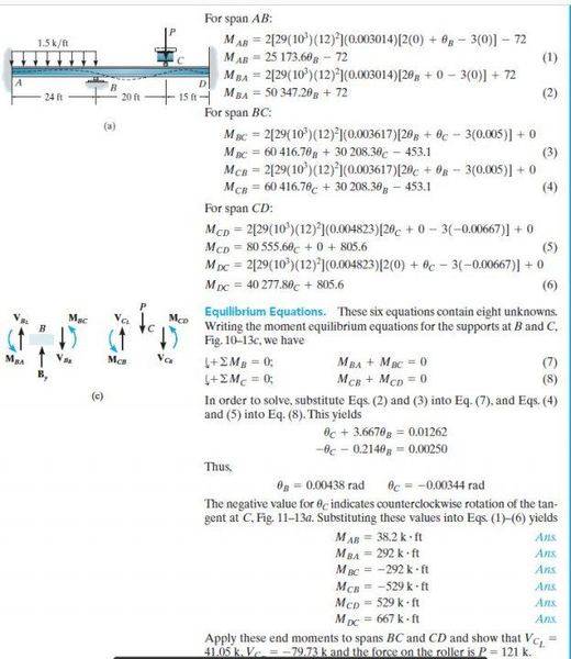

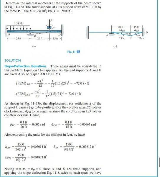

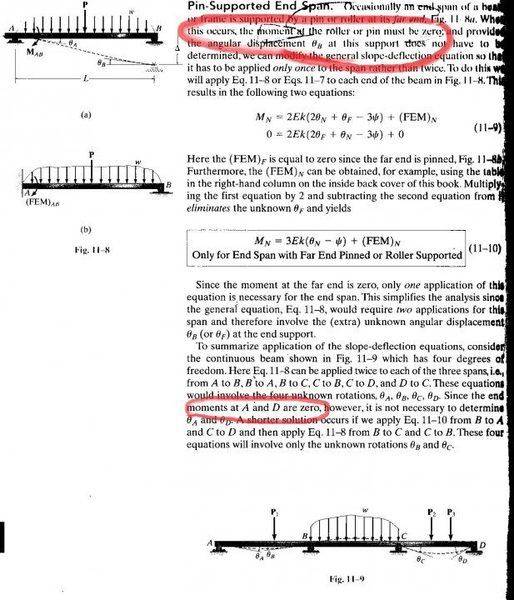

In the first photo , i was told that the fixed end moment is zero when the far end is pinned or roller supported . Why in the example in the second and third photo( both end are fixed) , the angle is zero ?
I think it's wrong , because the fixed end must be able to resist shear force . In conjugate beam method , angle of rotation = shear force . So , as the fixed end can resist the moment , there must be some values for the angle if rotation , am i right ?
