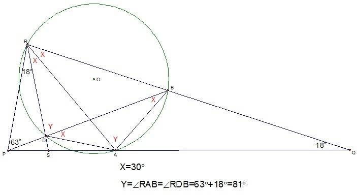

My solution:

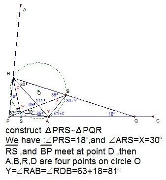

I couldn't quite follow Albert's solution.
The following also uses the circumcircle of triangle RAB. Also it's written as a slight generalization. It is critical that angle ARQ is 30 degrees. The original problem has $\theta$ equal to 21. So angle RAB is 81.
Albert,
I understand perfectly if quadrilateral PDAB is cyclic. This was my original problem, and I still can't see why it's true.
johng said:
Albert,
RDAB is cyclic not PDAB
Albert,
Sorry, it was a typo. My problem is: why is quadrilateral RDAB cycliC? I can prove this only by knowing the answer.
Thanks, johng for participating and your solution is correct, well done!:)

Albert said:
johng:
Can you follow my solution now ?
anemone:
If you are still unable to follow it,I will use the following method (forget the circle)
$x=\angle DRA=30^o=\angle ARB$
$\angle ABQ=x+y=111^o=63+18+x=63^o+48^o$
$\angle RAB=111-30=81^o=y$
