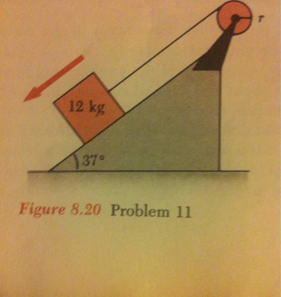

A 12 kg mass is attached to a cord that is wrapped around a wheel of radius r = 10 cm (Fig. 8.20). The acceleration of the mass down the friction-less incline is 2.0 m/s^2/. Assuming the axle of the wheel to be friction-less, determine (a) the tension in the cord, (b) the moment of inertia of the wheel , and (c) the angular speed of the wheel 2 s after it begins rotating, starting from rest.
F = ma
I found the tangential force by using F = ma and found it to be 24. I am not sure how to continue to find the angular acceleration and moment of inertia because the question doesn't give the mass of the wheel.

OK so I need to find the acceleration of the block down the hill and that will be the acceleration on the wheel? If so how do I do that?
You don't need to find the acceleration of the block down the hill, because the problem has already told you that it is 2 m/s^2
The linear acceleration of the block is equal to the linear acceleration of the edge of the wheel.
(This assumes the rope doesn't slip on the pulley, which you need to assume for the problem to be solvable.)
This gives you the equation:
a [itex]=\alpha r[/itex]
Where "a" is the linear acceleration (=2 m/s^2) and "[itex]\alpha[/itex]" is the angular acceleration of the wheel.

OK I did that and got the last part of the problem right. However, I am still having trouble with the second part of the problem. So
Ft = ma
Ft = 12(2)
Ft = 24
T = Ft*r
T = 24 * .1
T = 2.4
T = I*a
T = I * 20
2.4 = I *20
I = .12
The correct answer is 0.234 kg * m2

Ft is the net downslope force on the block, right? But you have equated that to the tension, which is an applied upslope force, and neglected gravity.
Why do I have to use gravity it already tells me that the block is accelerating down the slop at 2 m/s^2?
Because the two forces on the block are gravity and tension (in opposite directions)
You don't know the tension, but you do know the gravity and you know the net acceleration (and thererfore net force) so you can use that to find the tension

The acceleration of the block is the net force on the block divided by the mass of the block.
The component of force due to gravity on a frictionless incline = m g sin(θ)
The opposing force is the tension in the rope = T.
The net force on the block in the direction of slope of the incline = m g sin(θ) - T
The acceleration of the block = (m g sin(θ) - T) / m = g sin(θ) - T / m = g sin(37°) - T / 12kg = 2 m / s^2, use this to solve for T. The unknown here is what value to use for g, 9.80665, 9.8, 9.81, ... ?

OK so I did that and am still getting the question wrong so
(g sin 37 -T)/12 = 2
g sin 37 -T = 24
5.898 - T = 24
T = -18.102
The book says the correct answer is 46.8 N
It acidentally double posted this... Is there a way to delete posts?
@rcgldr, I don't see a delete button. (I've seen it, and used it, before, but it's now nowhere to be found)
it should be:
g sin(37°) - T/12 = 24
(The "g sin(37)" is already divided by 12, because it was originally "mg sin(37)" so you don't need to divide it by 12 again)
Continuing from post #14, as mentioned g sin(37°) was already divided by the mass of 12 kg:
(9.80665) (0.6018) - T / 12 = 2
T/12 = (9.80665) (0.6018) - 2 = 5.9018 - 2 = 3.9018
T = (12) (3.9018) = 46.82 N

Heres my take on this problem :
g assumed at 9.81 (m/s)/s
The force down the slope created by the mass of the block = m * g * ( sine ( 37 ° ) )
= 70.8457 N
The force required to accelerate the 12 kg mass @ 2.0 ( m / s ) / s
= m * a
= 24 N
The remainder must be driving the wheel = 70.8457 - 24 = 46.8457 N
(this is the tension on the string)
The torque on the wheel = 46.8457 * 0.1
= 4.68457 N-m
The angular acceleration = 2.0 / 0.1
= 20.0 ( rad / sec ) / sec
The mass moment of inertia :
= torque / angular acceleration
= 4.68457 / 20.0
= 0.2342 kg-m²
The angular rotation rate after 2 seconds :
= angular acceleration * time
= 20.0 * 2.0
= 40 rad / sec
