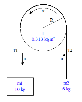

An Atwood machine is a rope that passes over a pulley with a block attached to each end of the rope so that the blocks are not in contact with the floor. The frictionless axle of the pulley is oriented horizontally, and the rope is vertical save where it makes contact with the pulley. Assume the rope has no weight. The pulley is a uniform disk with a moment of inertia of 0.313 kg m² and a diameter of 0.5 meters. The first block has a mass of 10 kg, and the second block has a mass of 6 kg. Begin with the blocks at rest and at the same height. What is the angular acceleration of the pulley?
net torque = Ia
a= angular acceleration and I=moment of inertia
m= 10kg
M= 6 kg
mg0.25 - Mg0.25 = Ia
0.25g(m-M) = Ia
0.25g*4 =0.313a
a=31.3
My answer is marked wrong but what's wrong with it?

If the pulley has rotational inertia, the tensions on the sections of rope on either side of the pulley are not equal. Call the tensions T1 and T2. Do a force balance on each mass, and a moment balance on the pulley. What do you get for these?

How could the tension on either side of the rope not be equal? My understanding is that one property of tension is that it is always equal throughout the length of a rope.
another question is if the pulley is frictionless then how could tension in the rope rotate the pulley?
The axle of the pulley is frictionless (so the pulley is free to rotate), but the part of the surface of the pulley in contact with the rope is not frictionless. There is static friction between the rope and the surface of the pulley, which prevents the rope from sliding over the surface of the pulley. This makes it possible to have two different tensions in the two free sections of the rope. This, in turn, also produces a moment which makes the pulley rotate.

T1 - 10g = 10(-A)
T1 =10g - 10A
A = ar = 0.25a
T1 =10g - 2.5a
T2 - 6g = 6A
T2 = 6g + 6A
T2 = 6g + 1.5a
T1 (0.25) - T2(0.25) = Ia
(2.5g - 0.625a) - (1.5g + 0.375a) = Ia
g = 1.313a
a = 7.46
I think that's right. Please let me know if it isn't.
I thank you for your help.
It looks good numerically, but it's missing the units :wink:
