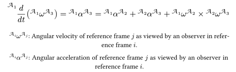

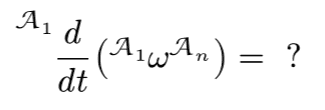

Hello,
I understand the equation that describes the angular accelerator when 3 reference frames are involved is:
Now I would like to ask what is the resulting equation when accounting more than 3 reference frames, i.e. when n-reference frames are involved.
Thank you.
