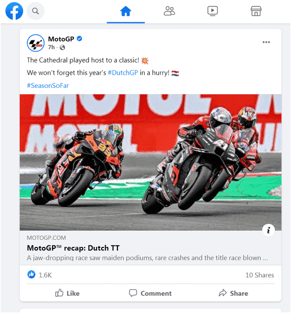

Things are a bit different on a motorcycle, since we have motors... :wink:
Likes Chenkel, hutchphd and jbriggs444
