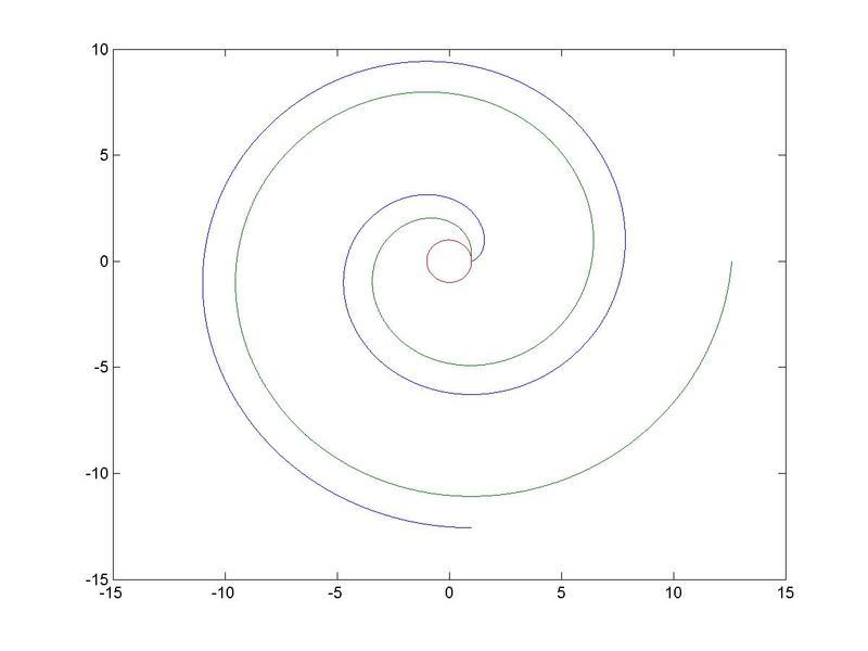

Link to picture of puck winding clockwise around a pole (I used the same radius for both).
From this picture, it should be clear that the tension in the line is pependicular to the path of the puck. The name of the spiral is "involute of circle". The distance from the side of the pole to the center of the puck equals the radius of the pole times the angle, which is the chord (cord? bad pun here) length around the circumference of the pole.
Defining "r" to be the radius of the pole, the paremetric equations for this curve are:
[itex]x\ =\ r\ (\ cos(\theta) \ +\ \theta \ sin(\theta)\ )[/itex]
[itex]y\ =\ r\ (\ sin(\theta) \ -\ \theta \ cos(\theta)\ )[/itex]
Link to picture of puck being drawn in towards a hole while moving clockwise.
From this picture, it should be clear that the tension in the line is not quite pependicular to the path of the puck, causing an increase in energy as the puck is pulled inwards. In this case, with the line being drawn into (or out of) the hole, the path could be anything, like an ellipse, but in all cases if the line is moved inwards or outwards there's a change in energy. For this example, I used an "equal angular spiral" since it looks nice. The (polar) equation for this is:
[tex]r\ =\ e^{a \theta}[/tex]

tabchouri said:
So, you telling me that the velocity is perpendicular to the tension of the string ?
Yes.
So I've spend more than half an our writing those equations in LaTex in vain?
Yes. You needed to start with the right equation for the path of the puck, which is "involute of circle".
Are you basing your conslusions solely on the picture?
No, it's based on the characteristics of that curve. As I mentioned, in the case of "involute of circle" the distance from the side of the circle to the spiral path is equal to the angle times the radius of the circle. If you were to wrap one end of a string around a post, say a flashlight, so the string couldn't slip, and the other end around a pencil, then drew a line with the pencil as you wound (or unwound) the string around the post, then "involute of circle" is the graph you would be drawing.
You can redo your equations, now that you know the equation for the path of the puck ("involute of circle"). Calculate the tangent and then the vector perpendicular (normal) to this path, and you'll find that it directly points to the edge of the post.

I've attached an image comparing what I got (inside in green) to the involution of the circle (outside in blue). Qualitatively both solutions look roughly like what I would expect, but you convincingly argued that it should be an involution.
I'm most frustrated. In case anyone is interested I got the solution
[tex]\ddot{r}=-r\dot{r}^2\frac{r^2-3a^2}{r^4-a^4}=-\frac{\dot{r}^2}{r}+\frac{3a^2\dot{r}^2}{r^3}+O(a^4)[/tex]
However I don't know how to solve these differential equations, so I can't get an exact solution. All I need is one integration so I could get [tex]\dot{r}[/tex] in terms of r and t, and analyse the effect of decreasing r on the motion is, assuming I haven't made any mistakes, which isn't beyond question seeing as the solution is not the involution of a circle.
Though all the assumptions that went into it seem physically plausible to me.
It feels like I'm using a sledgehammer to crack a rather soft nut. Maybe a different approach would be simpler. It's just hard if the string does work on the puck, since then the Lagrangian approach won't work. And the motion isn't obvious, though after thinking about it and throwing some balls around I strongly doubt the speed increases significantly as the puck moves inwards, and I doubt the kinetic energy of the puck increases.
Frustrating.
Edit: I think I can see what happened. I said as the string moves through a small angle [tex]d\theta[/tex] the string's length decreases by [tex]Rd\theta[/tex], but as Jeff Reid pointed out, this angle is not the same as the polar angle. I'm far too bad at picturing situations.

Ok, you're probably sick of me now, but I'll post what I've got thus far, sans details. From my failed previous attempts you're probably not too confident in my result - I'm not either, but each time I'm getting closer to the solution.
I got, using something like Jeff's geometry (l is instantaneous length of string, r is radial distance from the centre, theta and phi are as in Jeff's diagrams)
[tex]d\phi=d\theta+\frac{adr}{rl}[/tex]
Which using
[tex]dl=ad\phi[/tex]
and geometry gives
[tex]rdr=ldr[/tex]
All together we get:
[tex]\frac{dr}{d\theta}=\frac{ar}{\sqrt{r^2-a^2}}[/tex]
Now use a bit of geometry to solve for the forces, crank the algebraic handle, and I got
[tex]\ddot{r}=-\frac{\dot{r}^2(r^2-2a^2)}{r^3}[/tex]
(My exact solution is rather close to my approximate solution from my last run through basically because the differential in theta is close to the differential in phi for small angles - and I used the wrong angle last time).
Cutting to the chase I don't know how to solve analytically. I hectically threw something together in matlab, toyed with the initial conditions until the rounding errors disappeared (it doesn't like it when r gets too close to a, as you'd expect). The solution looked something like a involution, but as I've already learned looks can be deceiving, and I haven't substituted the equations for an involution back in for theta (though they look close to me, again looks aren't everything).
Cut to the chase. Over time [tex]\dot{r}[/tex] increased as r decreased. In fact a plot of r versus [tex]\frac{1}{\dot{r}}[/tex] was a straight line. This agrees with my approximate solution from post 26 (again my bad geometry becomes irrelevant at small angles, thankfully).
Though I'm sure you're not completely convinced by my analysis, and neither am I.
In any case, unless someone else has evidence otherwise, I propose:
The kinetic energy is always conserved. It drops out beautifully of these new equations that the angular work just cancels the radial work. A Lagrangian approach is hence fine. (My apologies to more physically minded people like Jeff that saw this right off the bat - I was having trouble with it).
Angular momentum is not conserved - the string exerts a torque on the puck.
The total velocity of the puck in the thin pole approximation is constant, but the radial velocity is inversely proportional to radius. The tangential velocity remains constant.
I suggest thus that the OP was measuring the radial speed. Alternatively he could have been measuring the angular velocity.
If there are any experimentalists out there that can give this simple experiment a go, I'd much appreciate the reality check.
