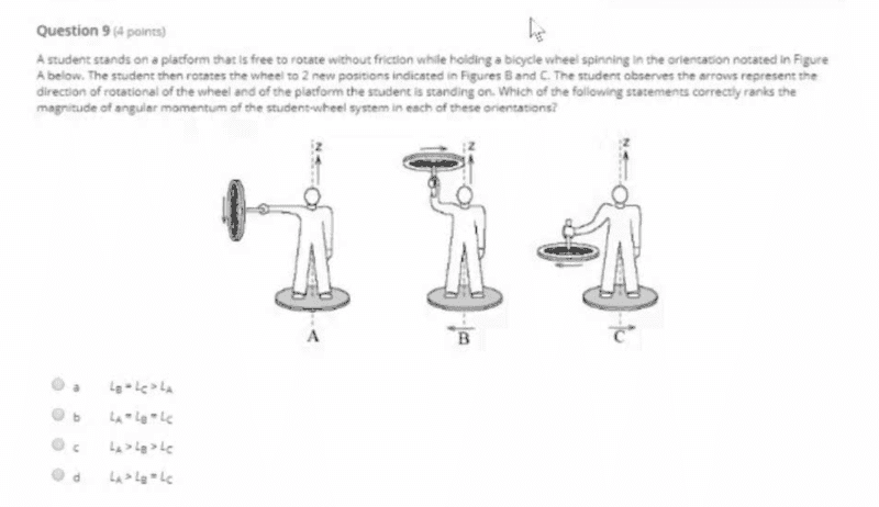

See image below.
N/A
I thought the answer is B because the angular momentum in conserved in all 3 pictures.

Conservation of angular momentum can only be assumed if no external torque operates. As the student manipulates the wheel, what external forces act on the student-wheel system? What torques might they exert?

I am not an expert in angular momentum but something tells me that states B and C have same magnitude (and opposite direction ) of angular momentum so the correct answer must be one from (a) or (d)

I find the image in post #1 too blurry to be sure, but it looks to me that a, b and d all have B and C equal.

I agree it cannot be conserved. In state A I think angular momentum is in the horizontal direction , while in state b and C in the vertical direction.

Angular momentum is a vector. For it to be conserved, it must have the same magnitude and direction in all three pictures. Does it?

Be a bit careful with that claim about the direction of the angular momentum in (b) and (c). If it is defined at all, it is vertical. But is it defined at all?

Consider what kind of torques that could act on the system given that it is supported by a (presumably frictionless) support rotating freely around its axis and what this implies for the vertical component of the angular momentum.
Edit: Also note that the objection people are raising is that the direction of angular momentum may be undefined. Not that angular momentum itself is undefined.

As I wrote, angular momentum is well defined. It is its direction that is not.

A vector is well defined if its direction and magnitude are both well defined. Yes, that is correct. However, the reverse implication does not hold. There is a condition under which a vector can be well defined without its direction being well defined.
Oh ok i see the zero vector.
Likes jbriggs444
Perhaps it would be helpful to ask what direction does the torque, if any, act relative to the angular momentum of the wheel? Can such a torque change the magnitude of the angular momentum of the spinning wheel? (assume there is no friction).
