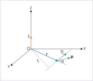

I do not think so...
If a mass does not rotate around its own center and does not rotate around other center ("O" in the picture), just moving straight, it still may have non-zero angular momentum.
Yes you are right jdg812, I kept r constant. You can zip by O in a straight light and have angular momentum with respect to O. In this case, r is a variable.
[tex] L = mvr \sin(\phi) [/tex]
As long as
[tex] \sin(\phi), p, r [/tex]
is not zero you have non-zero angular momentum.
