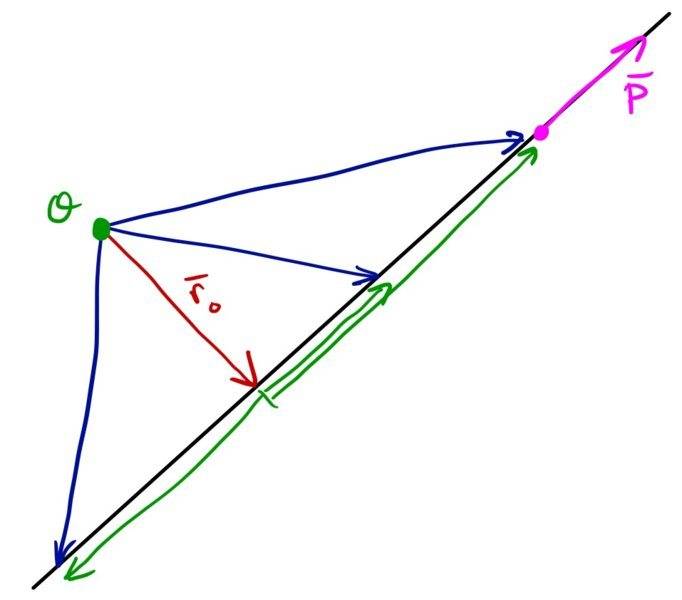

A particle (5 kg) moves with constant velocity 2 m/s along the straight line 2y=3x+4, the angular momentum of the particle about origin is?
L=r x p
For a 2d problem we take the component of velocity perpendicular to the point about which we want to find the momentum and multiply it with the perpendicular distance. Here slope of the line gives tanθ=3/2, p=mv=10 and L=mvrcosθ, mvcosθ equals 20/√13 but isn't the distance r (here r=the y coordinate of the particle) continuously increasing? I get the correct answer for r=2 though, I don't understand how. I'd really appreciate some help, thank you
##\vec r \times \vec p## only depends on the part of ##\vec r## that is orthogonal to ##\vec p##.
I know only the very basics of vectors, (its yet to be reached in our mathematics coursework). I suppose the part of r that's perpendicular to momentum is what you mean but that part seems to be increasing with time as well
Why do you think so? (It is not correct)
Here is a quick drawing of the situation.
The red vector is always the part of the position vector orthogonal to p. The blue vectors are different position vectors for the part let moving along the black line and the magenta vector its momentum. The green vectors are the components of the position vectors not perpendicular to p.
Ohh, I understand really well where I was thinking wrong. The diagram helped a lot. Thank you :D
