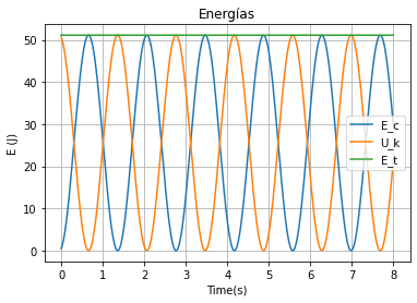

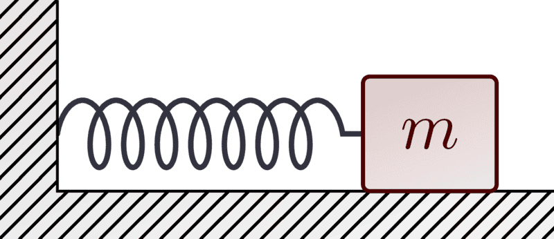

For example, I wrote some code to calculate the movement of a mass attached to a spring with some friction with the ground.
$$m\ddot{x} = -kx - \textup{sign}\left (\dot{x}\right ) \mu N$$
If I make the friction coefficient ##\mu = 0## then the energy of the system should look like this:

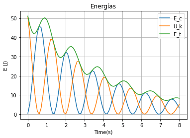

You can see how the potential energy in the spring and kinetic energy in the mass balance each other to keep the total energy in the system constant.However, if the step size is not small enough, then the energy is not conserved.
I can't remember exactly but I believe every time I have seen it happening energy is not conserved because it gets lost. I don't think I have ever seen the opposite where energy is created. It's not relevant to the point I'm trying to make but it's something I've always felt curious about. Maybe it's just related to the iteration process I use for the calculations.
