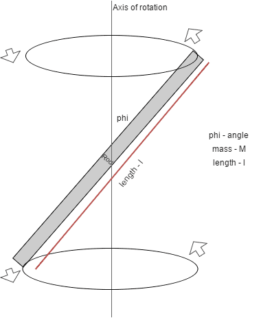

A thin rod of length l and mass M rotates about a vertical axis through its center with angular velocity ω. The rod makes an angle φ with the rotation axis. Determine the magnitude and direction of L (angular momentum).
So we're given: mass - M, length - l, angular velocity - ω, angle - φ
2. Homework Equations
I know that I have to use L = r × p = r × vm
In this case L = I⋅ω is not valid because L and ω vectors are not perpendicular
So it tried this...
I used the L = r × vm
but because my object is a rod with uniform mass I take the derivative of L = r × vm to get dL = r × vdm
because it's a derivative I have an infinitely small mass dm, so I said that dm=(M/l)dr
r is now the radius of a point mass on the rod from the center of mass
v is the velocity of that point mass, and since we know ω we can use v = ωr
and so I get that v = (r sinφ)ω [rsinφ is the perpendicular distance to dm from the axis]
1. I start here
dL = r × vdm
2. I now integrate both sides to get L
∫ dL = ∫ r(rsinf)wdm =
3. I integrate from -l/2 to l/2 because that is the length of the rod
L = ∫1/2-1/2 (r sinφ) w(M/l)dr
4. I now plug in the two values
L = (r3/3)(sinφ)(ωM/l) |1/2-1/2
so after plugging everything in I get: L = (sinφ ω M l2)/12
MY QUESTION: IS THIS CORRECT? I did a lot of guessing because I could not find anything similar to this in my physics book or online.
1. Is my thinking correct?
2. Am I allowed to integrate ∫
r(rsinf)wdm because r × vm is a cross product.
(diagram are included)
Thanks

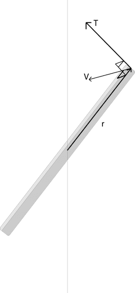

Okay so this is what I imagine the problem looks like. Velocity vector V is pointing into the paper and r has an x and y component and then Torque T is perpendicular to both V and r
This is correct right?
You mean that the angular momentum is perpendicular to both r and v.
You can get the components of the angular momentum, as Simon suggested. One component changes with time as the rod rotates, the other is constant.
Also remember that the magnitude of the cross product |axb| = a*b sin(θ) where θ is the angle between a and b. You know this angle , so you got the magnitude of the angular momentum already in your first post.
