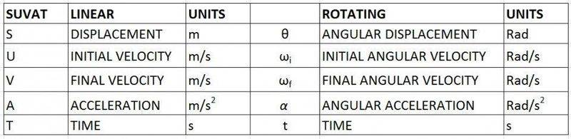

ω is the angular velocity. You calculated the angular velocity after 2.25 seconds as 74.9 rad/s in question a).
Useful reference (better version)..
For part c, the angular speed is an inital or final speed? meaning is it w0 or w?
The question asks for the angular velocity after turning. So it is the final angular velocity you need to calculate.
since theta=35rad, w0=74.7rad/s, T=2.25s, A=33.2,
I would use V = w0 + A*T correct?, ok Ived tried a few of them with V in them and none are giving me 48.2. I used, for example tried theta=((w0+v)/2)*t and V^2=w0^2+2*A*theta, can you please tell me what I am doing wrong?
Sorry I had to delete a few posts. I'm rushing too much. The equation you need is..
ωf2 = ωi2 + 2αθ
which is similar to
V2 = U2 + 2as
ωi = 0 (starts from rest)
α = 33.2 rad/s2 (from the problem)
θ = 35 rads
Thank you. And for part b did you get an answer around 84 point something, casue I used the theta=w0(t)+.5*a*t^2 equation?
Yes 84.04 rads.
