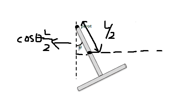

There are two identical, uniform rods each of length 𝐿 and mass 𝑚 forming a
symmetrical T-shaped pendulum as shown.
The pendulum is released at some angle 𝜃 (less than 90D). Derive the angular velocity of the pendulum when the 𝜃 = 0.
So this question has something probably due to the conservation of angular momentum. I am able to find the moment of inertia about the pivot, which is :
$$\dfrac {1}{3}mL^{2}+\left( \dfrac {1}{12}ML^{2}+mL^{2}\right) =\dfrac {17}{12}ml^{2} $$
Now to find angular velocity when angle =0, how am I able to apply the conservation of angular momentum law without knowing the initial angular speed and angle? (even though they tell me to release less than 90 --> what does this imply in this case?)
Thanks

Alright.. So if I use the energy method:
If I take the dot as the origin, is it safe to say that:
$$mg\left( \cos \theta \dfrac {L}{2}\right) =\dfrac {1}{2}I\left( \dfrac {v}{r}\right) ^{2} $$
where left hand side shows the GPE , no KE at initial angle, and RHS as when theta =0, and there is no gpe
jisbon said:
$$mg\left( \cos \theta \dfrac {L}{2}\right)$$
Remember that only differences in potential energy are physically meaningful. This oversight masks the fact that you also have a sign error here.
And that the lower rod also has mass and mechanical energy (potential and kinetic) ...
Likes jbriggs444
Further to @jbriggs444's comment...
Which dot? I see one at the pivot and another half way down.
How are you defining I?
What is r?
