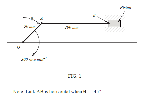

I have been set this question and I am struggling with parts b and c. I think I am nearly there but can't quite get over the line. Please could someone give me a nudge in the right direction.
[/B]
1. (a) For the mechanism shown in FIGURE 1 determine for the angle
θ = 45°:
(i) the velocity of the piston relative to the fixed point O (VBO)
(ii) the angular velocity of AB about point A (i.e. ωAB)
(iii) the acceleration of point B relative to A (aBA).
(b) Determine the value of the angle θ (measured from vertical) when:
(i) the velocity of point B = 0
(ii) the angular velocity of link AB a maximum.
(c) What is the maximum angular velocity of link AB?
1i) VBO = 1.1 ms-1
ii) ωAB = 5.55 rads-1
iii) 13.6cm and 40.8ms-2
The above I am happy with my answers which is why I have not included all my calculations and diagrams. Below is my attempt at the remaining questions.
1b)i) When the velocity of B is 0 ms-1 the piston must be either fully extended or fully retracted.

I am not looking for answers here just a nod in the right direction as I feel that I may have strayed off path a little here.
Thanks in advance for any help.

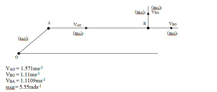

Sorry for my delay I have been away for the weekend. Thank you for the help so far. Below I have added my calculations for question 1 and the relevant diagrams should be attached too.
1i)
VAO = lOA x ωOA
= 0.05 x 31.42
= 1.571ms-1
VBO = cosØ x VAO
= cos45° x 1.571
VBO = 1.11ms-1
1ii)
VBA = sinØ x VAO
= sin45° x 1.571
= 1.1109ms-1
ωAB = VBA
lAB
= 1.55
0.2
ωAB = 7.76 rad s-1
DIAGRAM 1

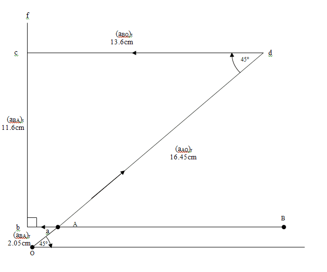

1iii)
(aBA)r = lAB x ωAB2
= 0.2 x 5.552
aBA = 6.16ms-2
(aAO)r = lOA x ωOA2
= 0.5 x 31.422
aBA = 49.36ms-2
From the acceleration diagram attached with a scale of 1cm = 3ms-2
(aBA)t = 11.6cm from diagram = 34.8ms-2
(aBO)t = 13.6cm from diagram = 40.8ms-2

JohnnyS said:
VBO = 1.11ms-1
I do apologise. i must have misread the question - twice!
JohnnyS said:
1ii)
VBA = sinØ x VAO
= sin45° x 1.571
= 1.1109ms-1
ωAB = VBA
lAB
= 1.55
0.2
ωAB = 7.76 rad s-1
I'm confused. You originally answered 5.55 and I agreed. Your attached diagram also shows 5.55.
JohnnyS said:
1iii)
(aBA)r = lAB x ωAB2
= 0.2 x 5.552
aBA = 6.16ms-2
Not following the algebra, but I agree that this is the radial acceleration.
JohnnyS said:
(aAO)r = lOA x ωOA2
= 0.5 x 31.422
aBA = 49.36ms-2
Not following this at all. You write aBA with two meanings? What is the method behind your calculation of the tangential acceleration?
Seems to me you missed a sin(θ) factor.
I suggest a safer approach is to write the angle AB makes to the horizontal as φ, say, and obtain the general equation relating the two angles and the two lengths (r=OA, L=AB). You can then differentiate to obtain components of velocities and accelerations in x and y directions.
I feel sure that will help with part b.

With regards to the question 1iii) I am not sure as to how to type in all the mathematical symbols so I used 'a' for acceleration so the radial acceleration at
BA = 6.16ms-2
Another typo in the next one which should read radial acceleration for AO = 49.36ms-2.
With regards to the tangential acceleration I have used the acceleration diagram drawn to a scale of 1cm = 3ms-2 to obtain the tangential acceleration BA =34.8ms-2 (11.6cm on the diagram) and tangential acceleration BO = 40.8ms-2 (13.6cm on the diagram).
Ok, but that is all invisible to me. I can only help if you use and post algebra.
Remember that the tangential acceleration of A wrt its rotation about B (an accelerating reference frame) is, in the diagram position, its vertical acceleration.
