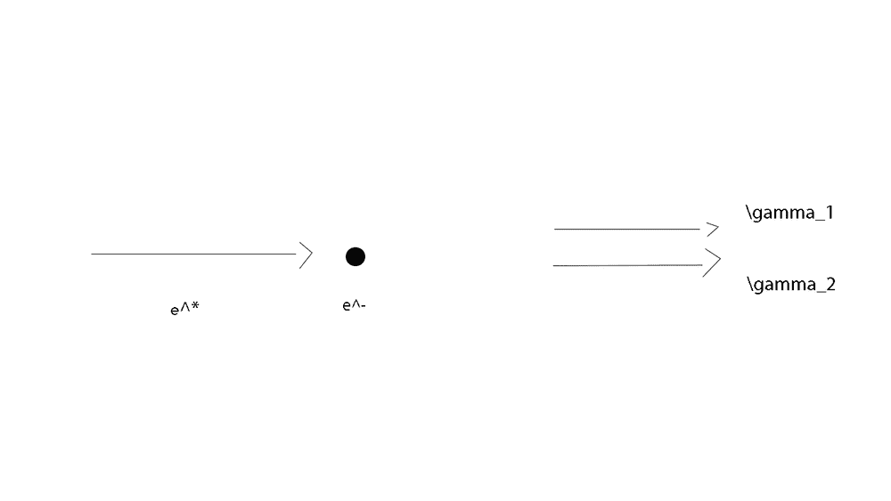

An antiparticle of mass ##m## and energy ##E## hits a stationary particle in the laboratory and the system annihilates itself producing two photons, which are directed along the direction of the motion of the incident antiparticle.
1 - Calculate the energies of the two photons in the laboratory's reference system.
2 - Calculate the energies in the reference system integral with the incident particle, explicitly carrying out the Lorentz transformation. Discuss the result obtained.

I was supposing this situation in LAB-frame:
So then, they have the same direction, but opposite verse and different module?
Frostman said:
For
They must be in opposite directions in all IRF's, as they must be in opposite directions in the CM frame.
