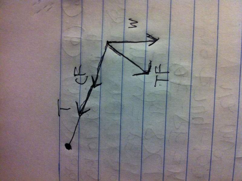

Here is my free-body diagram. The T stands for tension, CF for centripetal force, TF for tangential velocity, and w for weight.
Do you see it now?
Likes 1 person
dauto said:
Do you see it now?
No I don't. What should I be seeing?
Ok, so we have a weight swinging around on a rope in circular motion. Let's look at the time when the rope is at the bottom of it's swing (so it's completely vertical) just to simplify things.
Suppose, like you said, that the tension in the rope is equal to the centripetal force.
What would be the net force on the weight (or person)? The tesnison is directed upwards (towards the center of the circle) but gravity is directed downwards, so what would be the Net Force on the weight? Would that Net Force be equal to the centripetal force?
For an object to move in a circle there must be a NET force equal to [itex]\frac{mv^2}{2}[/itex]
If the tension was equal to [itex]\frac{mv^2}{2}[/itex] then would the Net Force be equal to [itex]\frac{mv^2}{2}[/itex]?
What must the tension be in order for the Net Force to equal [itex]\frac{mv^2}{2}[/itex]?
(Hint: The tension is not constant throughout the swing)

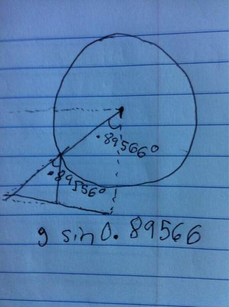

Alright now I am having trouble with the angle. I know that at 1.5 m above the ground the force of gravity is perpendicular to the ground and in order to find the amount of that force that effects the tension I have to use trigonometry. So T = 1/2mv2 + mg sin θ (or cos θ). The problem I have is that I don't know whether to use sin or cosine or how to find the angle. Do I use radians to find the angle?

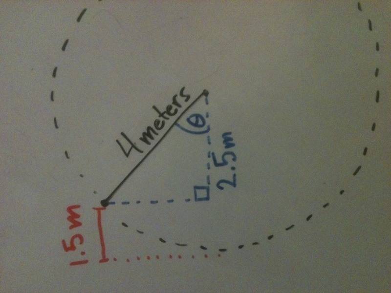

First step is to find the angle. How? Draw a picture.
Can you find the θ in my picture? (Maybe I shouldn't have labeled the 2.5m side haha)
If you're stuck on whether to use cosine or sine and whatnot or something else I want to see you draw a picture to try to figure it out

Nathanael said:
First step is to find the angle. How? Draw a picture.Can you find the θ in my picture? (Maybe I shouldn't have labeled the 2.5m side haha)If you're stuck on whether to use cosine or sine and whatnot or something else I want to see you draw a picture to try to figure it out
I found theta by doing the inverse cos of 2.5/4 = .89566. I found out whether to use sin or cos by drawing the picture. So
T = 70(7)/2 + mg/ cos .89566
T = 1715 + 686 / cos .89567
T = 2812.59
This is not the correct answer
Ignore the caption under the photo
Don't you want g (or mg) to be the hypotenuse? Because you're trying to break up the force of gravity into it's components (specifically it's tangent and perpendicular components)
Your drawing is wrong, gravity should be the hypotenuse.EDIT:
Can you explain your calculations?
Also in your drawing you put 0.89566 degrees, but it would actually be radians (I don't think this effected your math though)Why didn't your calculation involve the centripetal equation?

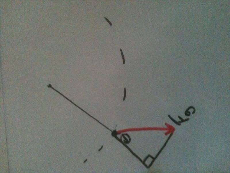

I thought the force of gravity always was a straight line down?
It is, but you can sill make it the hypotenuse. Look at the drawing I've attatched, that is how it should be.

Nathanael said:
It is, but you can sill make it the hypotenuse. Look at the drawing I've attatched, that is how it should be.But why didn't your calculations involve the centripetal force equation?
Ok I did that but I'm still not getting the right answer. I did
Mg cos .88566 = 428.75
Then I plugged that into the equation
Mv^2/r + 428.76 = T
70(7)/2 + 428.75 = 2143.75
Which is not the right answer
I got the velocity 7 from an earlier calculation attempt.

haruspex said:
Your main error is here:
Passing over the missing power of 2 on the 7 (just a typo), r is not 2.
hahah of course I (and you, brainman) was mixing up the centripetal equation with kinetic energy equation
You had it all right, you (and I) just made a silly mistake :)
