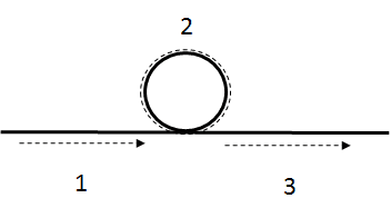

Here is a scenario in which two twins age at different rates even though both always have the same speed.Consider a train track that includes a circular segment with ground circumference minutely greater than 80. Two twins are on a train with synchronized watches (Frank at the front and Reba at the rear). The train has proper length 100 and velocity in the inertial ground frame of 0.6c. While traveling inertially (point 1 in the diagram below), in the ground frame the train’s length is 80 and Reba’s watch is ahead of Frank’s by the product of the train’s proper length and its speed, or 60. The tracks shunt the train into the circular segment as it passes. After completing the circuit around the circle, the front of the train exits just as the rear has entered, and Frank grazes Reba (point 2 in the diagram below). At this event, they compare watches. Each has traveled at the same speed the entire time (0.6c), and therefore Reba’s watch remains 60 ahead of Frank’s in the ground frame. Because they are both at the same event, Reba is 60 older than Frank. Frank has aged 60 less than Reba during his circuit.
Thereafter Frank and the front of the train travel inertially to the right; Reba and the rear of the train complete the circuit, exit the circle, and then continue inertially to the right (point 3 in the diagram). Each watch has continued to travel at the same speed; Reba’s watch continues to be 60 ahead of Frank’s in the ground frame; but their watches are now synchronized again in their inertial frame. Reba has aged 60 less than Frank during her circuit.In this scenario the twins age at different rates during their travels even though they always travel at the same speed. The change of direction acceleration within the circle causes the different aging. Speed has an impact, but only on the amount of differential aging during acceleration (the product of the train’s proper length and speed). The proper length has an important role also. If you double the proper length of the train and the ground circumference of the circle while maintaining the train’s speed at 0.6c, you double the time during which the train undergoes change of direction acceleration, and you double the amount of differential aging that occurs during the acceleration – even though the twins continue to travel at the same speed at all times, and it is the same speed (0.6c) as they traveled on the shorter circumference.I’d appreciate your general thoughts on the scenario and any specific views you can offer on which twin’s worldline is longer during the period between Frank entering the circle and his grazing Reba. Presumably his worldline is a helix and hers is a straight line; each travels the same distance in the ground frame over the same time in the ground frame; but I do not know how one measures each worldline to determine which is longer, and what the measure of each is.
Thanks.

Let the origin be Frank crossing the points for the first time. In the ground frame, then, his x and y coordinates in terms of t are:[tex]\begin{eqnarray*}
x&=&R\sin(vt/R)\\
y&=&R-R\cos(vt/R)
\end{eqnarray*}[/tex]where R is the radius of the track and v is the speed of the train. Then you can write [tex]dx = \frac{\partial x}{\partial t}dt = v\cos(vt/R)dt[/tex]and similarly [itex]dy=v\sin(vt/R)dt[/itex]. That let's you write that [tex]d\tau^2 = dt^2-dx^2-dy^2 = (1-v^2)dt^2[/tex]You can trivially integrate [itex]d\tau[/itex] over the period Frank is in the circle, or just note that Frank's proper time has the same ratio to t as Reba's does. Either gives you the result Peter stated in #2.
The reason that their clocks drift in and out of sync in the inertial frame of the straight bit of the train is that while they are going round the circle they are changing simultaneity conventions in a non-trivial way. I think this is related to what happens in Bell's paradox, where clocks at the nose and rear of a rocket initially synchronised in its rest frame are not synchronised after a period of acceleration.
Likes JVNY

Great comments, thanks. I will go over them separately. The main issue to keep in mind is whether the scenario shows that acceleration rather than speed causes the differential aging. The standard view is that speed, not acceleration, causes differential aging.
A.T. said:
Synchronized in which frame? Train or ground?
Initially synchronized in the train frame.
A.T. said:
To me the issue is that they don't have two meetings, to compare proper time intervals between them locally.
However, they both start in the same inertial train frame with synchronized watches, so we know how their proper times begin. They can also send signals to each other to Einstein synchronize their watches while they are inertial. Then they meet when Frank grazes Reba, and they can compare their proper (wristwatch) times then to determine the lapse of each's. You can even assume that they were born at the center of an always-inertial train, then were carried at the same time at the same speed measured in the train frame to the opposite ends of the train, so that at all times their bodies aged at the same rate before Frank entered the circle.

First, look at the motion from Reba's frame. The track comes along, picks up Frank, circles him round and drops him at her feet! Originally their watches were synchronised in their frame, but now his watch is behind in their frame.
From the ground frame: initially Frank's watch was behind. Both watches progressed at the same rate while Frank did his loop-the-loop, so Frank's watch was still behind by the same amount when he landed at Reba's feet.

But is it even correct to use the inertial ground frame as the base for the diagram? As discussed more below, there are issues with simultaneity and simultaneity conventions for Frank and Reba, so is it correct to measure their worldlines in a frame that always has a single simultaneity surface?
You can perform a correct analysis in any frame you choose, but you have to pick one particular frame and stick with it. It's easiest to use an inertial frame, more generally you can pick any coordinate system you choose and use the techniques of General Relativity with an appropriate metric. But let's stick with inertial frames as that's the easiest approach.
If you perform the analysis in the inertial ground frame, the problem is perhaps easiest to solve. In that frame, which I will call the lab frame, Frank and Reba's clocks were never synchronized. Their synchronization state remain unchanged, as they traverse the loop. They start out unsyncronized, remain unsyncronized by the same amount throghout their travels. So there will be a constant time difference (in that frame), it will be the same before frank enters the loop, when frank meets reba, and when reba has also gone through the loop. Of course, Frank and Reba are at the same point in space only at one point, the point where they meet, otherwise they are never both in the same spot at the same time.
If you perform an analysis in the frames that are represented by 1 and 3 in your diagram, an inertial frame co-moving with the train (i.e moving to the right on the diagram), you get the same answer to physical prediction of what happoens when they meet up, but the explanation is different. In that frame, then the clocks start out synchronized. However, the train's velocity in that frame is NOT constant as it traverses the loop (it starts out as zero at the bottom of the loop, and becomes negative at the top of the loop, returning to zero again when the train reaches the bottom again). So in that frame the clocks start out synchronized, become unsyncronized when Frank goes through the loop due to Frank's non-constant velocity profile. The clocks then become re-synchronized when both Frank and Reba have gone through the loop.
No matter which approach you take, you get the same prediction, that Frank and Reba's clock do not read the same when they meet.

So let's go with the worldline approach. How long is the worldline of each starting at the point at which Frank enters the circle through the point at which he exits the circle and grazes Reba as she has entered the circle? Can anyone calculate the actual length of each worldline? That would really help.
JVNY said:
Frank and Reba are twins and have the same age at the outset in their shared inertial train frame.
But they aren't spatially co-located in that frame, so there is no absolute sense in which they "have the same age"; their "age" as you are using the term is frame-dependent. Differential aging is an absolute--you have two twins who start out spatially co-located, so their relative age at that point is an absolute, invariant fact; then they separate, then they come back together, so they are spatially co-located again, and their relative age has changed, again as an absolute, invariant fact. This never happens in your scenario; Frank and Reba are only spatially co-located once, when Frank is exiting the circular shunt and Reba is entering it.
You could modify your scenario to add a second event at which they are spatially co-located: just add a second circular shunt. The simplest way is to put it a distance of 80 down the track from the first shunt, so Frank enters the second shunt, in the ground frame, at the instant Reba is exiting the first shunt. Then Frank and Reba will be spatially co-located again when Frank exits the second shunt and Reba enters it: and, what's more, they will see that they have both aged by the same amount between their two meetings. So once we add a second meeting to your scenario to evaluate differential aging, we see that there isn't any.
I understand how to do it in the inertial lab frame, and I see that their clocks tick at the same rate. They do not start co-located, but it seems theoretically possible to determine their worldlines in that frame. I think that everyone is suggesting that their worldlines in that frame are the same length (because both of their clocks tick the same amount in that frame).
Does that mean that they have the same length worldlines in all frames? I thought that that was the case. I can see where their worldlines end in all frames (when they meet); I am now confused on where their worldlines begin in any frame other than the lab frame (where they begin 80 apart in space), because it seems that I cannot compare their ages at the start of the scenario. I could start them at 100 apart in space and 0 apart in time in the train frame each with the same body clock time, but I fear that that looks as if I think that they have the same absolute age at the start, which seems not to be the case.

JVNY said:
I thought that when two observers are in the same inertial frame then there is an absolute sense as between them in which they have the same age.
Nope. See above.
JVNY said:
Say they are two artificial people born at the same train frame time on opposite ends of the train and they have the same pre-determined lifetime measured by an ideal built in body clock (say 160). Then they can communicate with each other throughout their lives and will die at the same time on the train. Neither can possibly see the other die as long as they both remain inertial. But in the scenario I described, Frank would live 60 longer than Reba.
No, he wouldn't. They would both live for 160 units of time. What you mean is, Frank would see Reba die. But that is because of the way you specified when each of their clocks started--at which event they were born--and how they moved. Suppose, for example, that Frank is born just as his end of the train enters the shunt. As you have specified the relationship between the births, that means Reba would be age 60 when her end of the train is a distance 80 from the shunt, in the ground frame (the event at which, in my discussion above, I had her clock reading zero--but now we're talking about a different specification for the zero points of the clocks). So Reba would be age 120 when she meets Frank, as she is entering the shunt and he is exiting it, and Frank would be age 60 at that event. So obviously he is going to see her die, because she was born earlier--at least, "earlier" in the only possible absolute sense at this point, since they only meet at this one event (Reba will reach age 160 and die before she even exits the shunt).
Also, as should be evident, Reba and Frank will not die "at the same time" in the original train frame either, because both of them will have moved non-inertially, and for different amounts of time by their clocks, by the time they die, so their death events will no longer be simultaneous in the original train frame, even though their birth events were. You can use an inertial frame to describe non-inertial motion, but you can't just assume that all of the same simultaneity properties will hold.

Ok, I think that I am beginning to understand.
This means that if I refer to the speed of Frank and Reba in the inertial lab frame, I must stick with the lab frame for all observations. Since they have 0.6c speed everywhere in the lab frame, I must draw their worldlines in that frame. In that frame their worldlines have the same length because each ages the same amount in that frame. Reba's is a straight line (sloped to the right for the 0.6c rightward velocity); Frank's is a helix; but the lengths are the same.
If I refer to the train frame then . . .

So I will use an inertial frame co-moving with Reba to the right.
PeroK said:
Instead, simply consider their initially synchronised watches in their initial inertial reference frame, where they are relatively at rest. One of them makes a journey to the other and thereby experiences less proper time than the one who remains inertial.
So, Frank starts out in that co-moving inertial frame, but then he leaves it when he goes in the circle and journeys to meet Reba. I simply ignore the ground frame entirely and just consider the inertial frame co-moving with Reba. In that frame, she is always at rest; Frank undergoes change of speed and change of direction:
In this frame, his clock runs slower than hers. His worldline is longer than hers.
PeroK said:
How is your scenario any different from one when one of the twins makes a high-speed journey to join the other?
I will try to answer this based on the explanations by the various posters.
In the original twin paradox the two twins start co-located. One makes a high-speed journey out and back (or around and back), then returns to co-locate with the other. My scenario is different in that the two start out not co-located.
When I draw the worldlines of the two in the lab frame, I have to have a starting event for each worldline. Say I start with Reba 80 away from the shunt and Frank, with her clock ahead of his by 60. She starts at a different event from him (separated as just described). They end at the same event (the two grazing). Their worldlines have the same length.
When I draw the worldlines in the inertial frame co-moving with Reba, the lines end at the same event as the ones drawn in the lab frame (the grazing). However, they start at different events: Reba at a place farther away from the shunt and Frank, and their clocks both reading the same. In this frame, Frank has a longer worldline; his clock runs slower. This is because of the different starting events (it cannot be because of the ending event, because each has the same ending event).
So the basic mistake that I made was thinking that being on the same simultaneity surface can be the starting point for their worldlines in all cases. I think that I confused being on the same simultaneity surface with being at the same event. I don't know whether this is a deep rooted inability to accept the relativity of simultaneity, or just inattentiveness to the definition of an event. I will read the Scherr paper and see.
In order to have an absolute, frame-independent comparison of the two worldlines, the lines must start and end at the same events -- which means that Frank and Reba must be co-located at the same event the beginning and the same event at the end of the lines. So the difference between my scenario and the original twin paradox turns out to be very significant.

(1) The event at which Frank enters the shunt. Frank's clock reads zero at this event. The corresponding event on Reba's worldline is the event at which her clock reads zero; at this event, she is not a distance 80 from the shunt in the ground frame, but further away, and the ground frame assigns a negative time coordinate to this event (see below for numbers).
(2) The event at which Frank exits the shunt. Reba's worldline also passes through this event, so it is the "corresponding" event for her as well, and her clock shows a higher reading than Frank's at this event (again, see below for numbers). So in this frame, we are looking at the same segment of Frank's worldline compared to what we looked at above in the ground frame (the helical segment that goes around the shunt), but a different segment of Reba's worldline compared to what we looked at above in the ground frame--a straight line segment that is longer than the ground frame one we picked.
Regarding numbers: it turns out that we have been making some erroneous assumptions about these, so I have given explicit calculations of the event coordinates in two frames: the ground frame, and the "initial" train frame, the one in which the train is at rest before anyone goes around any shunts. I have put the spacetime origin of both frames at the event where Frank enters the shunt.
The relative velocity of the two frames is ##0.6##, so we have ##\gamma = 1.25## and ##\gamma v = 0.75##. So the Lorentz transformation equations are (the ground frame is unprimed and the initial train frame is primed):
x' = 1.25 x - 0.75 t
t' = - 0.75 x + 1.25 t
The inverse transformations are:
x = 1.25 x' + 0.75 t'
t = 0.75 x' + 1.25 t'
The events are:
Event F0: The event where Frank enters the shunt; his clock reads zero at this event. This event has coordinates ##(0, 0)## in both frames.
Event R0: The event where Reba's clock reads zero. This event, by hypothesis, has coordinates ##(-100, 0)## in the primed frame, since the train's proper length is 100, so Reba is a distance 100 behind Frank at this event in the primed frame. The unprimed coordinates of this event are therefore ##(-125, -75)##.
Event R1: The event where Reba is a distance 80, in the ground frame, from the shunt. This event has coordinates ##(-80, 0)## in the unprimed frame. It therefore has coordinates ##(-100, 60)## in the primed frame.
We can already see that something is wrong with the assumptions we have been making, by comparing the coordinates of events R0 and R1. Between these events, in the primed frame, Reba's clock advances by 60; but in the unprimed frame, there is only a distance 45 between these events (-125 to -80). We have been assuming, all through this thread, that Reba's clock would advance by 60 in the time it took her to cover a distance 80 in the unprimed frame; but now we can see that must be wrong--in fact, her clock advances by 60 in the time it takes her to cover a distance of only 45 in the unprimed frame. (Note that it takes her a time 45/.06 = 75 in the unprimed frame to cover this distance, and 75 divided by the time dilation factor of 1.25 is 60, so this works out.) We'll see further corrections when we look at the next event below.
Event F1: The event where Frank exits the shunt. Reba is just entering the shunt at this event. The question is, what are its coordinates? It seems like, in the primed frame, they should be ##(-100, 120)##, because Reba is at ##x' = -100## and we assumed that her clock reads 60 elapsed time between event R1 and this one. But what does this transform to in the unprimed frame? It transforms to ##(-35, 75)##. That can't be right, because this event should be at ##x = 0## in the unprimed frame, since the shunt entry and exit are at the same point in space in this frame, which is the spatial origin.
So we have to take a step back and re-evaluate, once again, how much time elapses on Reba's clock while she covers a distance 80 in the ground frame. The train is moving at ##v = 0.6##, so it takes a time ##80 / .06 = 133.33## in the ground frame to cover that distance. So the coordinates of event F1 in the unprimed frame must be ##(0, 133.33)##. In the primed frame, this transforms to ##(-100, 166.67)##. So between event R1 and this event, Reba's clock advances by 106.67; and that is the unprimed time of 133.33 divided by the time dilation factor of 1.25, so once again it works out.
In other words, when Reba and Frank meet, Reba's clock does not read 120, as we have been (incorrectly) assuming all through this thread; it reads 166.67. We can see this another way: in the initial train frame, when Reba's clock reads zero, the shunt is a distance 100 away from her. But the shunt is moving at ##v = 0.6## in this frame, so it will take a time ##100 / 0.6 = 166.67## in this frame to reach Reba.
This also means that, when Reba and Frank meet, Frank's clock does not read 60, as we have been (incorrectly) assuming all along; it reads 106.67. We can see this from the above--it's the time in the unprimed frame that it takes to cover a distance 80 in that frame, divided by the time dilation factor of 1.25--but we also expect it because we know Frank's clock is 60 behind Reba's with respect to the ground frame.
So to sum up: in the ground frame, we are comparing the segment of Frank's worldline between events F0 and F1, with the segment of Reba's worldline between events R1 and F1. These segments both have length 106.67. But in the initial train frame, we are comparing the same segment of Frank's worldline (F0 to F1) with the segment of Reba's worldline between events R0 and F1, which has length 166.67.
This analysis appears to be basically the same as the rest of your post, just with the numbers made explicit (and the erroneous assumptions we were making about the specific numbers corrected).
