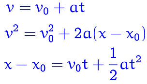

A parachutist bails out and freely falls 59 m. Then the parachute opens, and thereafter she decelerates at 2.7 m/s2. She reaches the ground with a speed of 3.1 m/s. (a) How long is the parachutist in the air? (b) At what height does the fall begin?
[/B]
59=0+1/2(9.8)t^2
t=3.47
Vf=Vo +gt
Vf=0+9.8(3.47)
Vf=34.01
_________
Vf^2=Vo^2+2(-2.7)(Y)
3.1^2=34.01^2-5.4(Y)
Y=212.42
212.42=34.01(t)-1.35(t)^2
I got 2 answers 13.7445 and 11.448 (due to quadratic formula)
they both equate to 212.42 so I need to choose and why. I got other answer correct except the t

You need to show units in your calculations. It makes it easier for others to check your work. You might also save having points deducted on exams for not showing units.
That said, why did you solve a quadratic to find the time elapsed after the parachute opens?
You are given the deceleration and the final velocity on striking the ground. You calculated the velocity at the end of freefall. This information is tailor-made for substituting into your first kinematics equation to find the time.

According to the OP, the parachutist decelerates at 2.7 m/s2 and lands with a velocity of 3.1 m/s.
Your calculations show that at the end of freefall, the parachutist has a velocity of 34.01 m/s.
I don't know how you solved the equation and got a time of 13.74 s to do this. Please show your work.

My original point was that solving the quadratic equation was unnecessary.
The first kinematic equation, v = v0 + at, works perfectly well for finding how long it takes for the parachutist to decelerate from freefall to a speed of 3.1 m/s on landing.
You know everything you need to find the time, t, as explained in Post #4.
