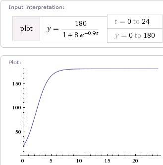

Here is a plot of the population function for the first 24 hours:
