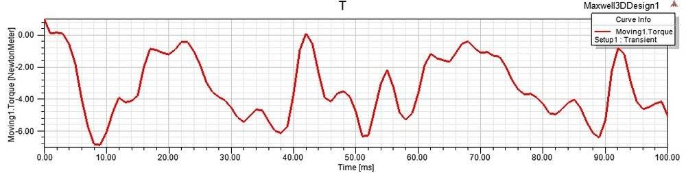

I do have a problem in ansys maxwell simulation of a generator. The moving torque (which represents electromagnetic torque) fluctuates around zero which is not correct. Induced Voltages are ok. How can I fix this problem?

Output voltages are acceptable but torque (moving toque in rectangular plot) is as the picture below:
Hamed Farnaghizad said:
Well, this is not a "torque fluctuating around zero" in the first place. Its seems like being periodic and with non-zero avg value. Negative value means, well, that it's a generator.
First thing: is thit a no-load operation ? And second thing: how would expected result look like ?
(Sometimes model reduction + symmetry boundary may introduce some issues).
Dear @gerbi
I connected three phase windings in delta connection and connected to a three phase Y connection 100 ohms load. As I calculated torque should be around 47 Nm. One surprising thing is that , No load and Loaded Torques are the same!
100 Ohms is rated load ? I mean calculated from ohms law for generator rated voltage and current. I assume the load is also arranged in 3-phase manner.

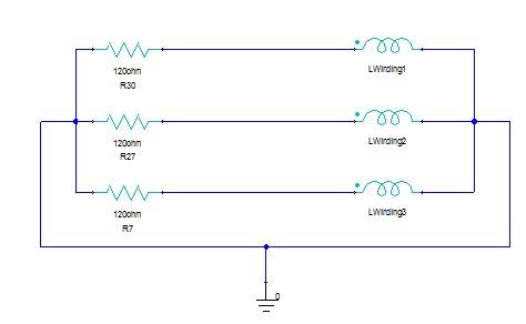

Well, I changed output circuit as the picture attached below, but no good result.
Actually by changing the resistance of the load output voltage of the generator varies!
Phase voltage unbalance may suggest that your model has some major issues. I'm sorry, but you need to review your model (geometry, excitation, parameter, motion setup and so on) and double check it for differences when compared to original design data. Then test it in no-load conditions (increase resistance in your circuit to values like 10^6 ohm). Observe all winding flux/voltages (they must be symmetric) as well as flux distribution in generator components. That's quite standard approach for design review. If no-load operation is fine then you can move to loading your generator.

I think the problem is of the circuit, I used circuit editor of maxwell.
I wanted to have a Delta-Delta connection but It needs GROUND so I don't know what to do to have a DD connection.
Well, you can always have Delta-Wye connection (Delta motor + Wye load with ground)...
Otherwise just ground one of load legs (ground is needed as a reference point).
