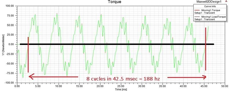

Hii Friends,
I was trying to model an Induction motor 5 KW in ANSYS Maxwell. The final output of Transient torque looks like shown below. It fluctuates with average torque almost equal to zero Nm.
The input passed is a sine wave current with 120 deg phase shift.
Any Suggestion will be highly appreciated.

Single phase ? Do you have a start winding on your simulation?
Likes RanchodDasChanchad
It is a three phase Induction motor, phases are shifted with 120 deg each.
That looks like it's third harmonic torque not line frequency.
Something like that can happen while the initial switch-on transients decay. What happens if you let it run for ten whole line cycles ?
Try switching two phases on first, third one two-thirds of a line cycle(240 degrees) later.
I know nothing about ANSYS , just trying to make it show what it's doing.
Thanks for your suggestions.
when I run ten whole cycle, same torque characteristics follow. Amplitude of torque reduces to half in 2.5 cycles and then reduced amplitude follows for rest of the cycle pattern.

I completed running the simulation for 10 full cycle. the average of torque is still zero but the amplitude reduces till 2.5 cycles and then follows till 10 cycles. like shown below:
I'm assuming you're working with 60 hz...
So the question becomes
'why does my simulation produce only third harmonic torque?'
Note that third harmonic of all three phases is in phase , what does your armature current look like? Is it 60 hz?
and i observe that your peak instantaneous torque is in the neighborhood of 75 N-m which at 1800 RPM would make around 18hp, which seems a lot for a 5hp motor but not impossible.
http://www.magtrol.com/support/motorpower_calc.html
And- why did torque fade with time? Are your simulated motor windings heating up and limiting current ?
What is your rotor resistance? Non-zero i trust. Low rotor resistance = low starting torque.
Almost, you say. Is rotor accelerating ?
In other words , somebody has to figure out what that computer program does. I've never seen ANSYS so can't be much help there..
Keep pinging away at it 'till something happens to give a clue.

Doesn't the first plot actually show that the armature is changing direction of rotation completely every few milliseconds ?
This suggests that the armature is being pulled in alternate forward and back directions by some incorrectly set up arrangement of field windings ?
Likes RanchodDasChanchad and jim hardy

Since we know nothing of what motor parameters he's given ANSYS (which appears to be a pretty thorough simulator)
we're all guessing.
My immediate suspicion is that rotor resistance is set to zero
in which case rotor mmf directly opposes stator mmf and no torque is developed (at fundamental anyway)
and line current will be quite high
and with those tremendous mmf's opposing one another i can imagine a lot of distortion in the flux
zero rotor resistance = zero rotor power factor
That's just a guess though.

He used the build in mathematical model to calculate the torque (Curve info: load and moving torques). The only other place to make a math mistake is at the excitation setup (current/voltage wave setup).
@RanchodDasChanchad: Check your excitation setup carefully (if the amplitudes/phase shift are fine). Next step - rotor setup. Is it a squirrel-cage ? Are there currents flowing in it ? Next thing: motion setup. If you won't find anything let me know via PM - I can take a look at it if you like to send me the file.
Hmmm Sure is experiencing alternating acceleration in opposite directions, and it seems to have not achieved rotation
so yes it appears to be hunting at about 3x line frequency , but why 188 hz not 180 ? And why those higher harmonics?

@jim hardy
Thanks a lot for your efforts and apology for the delay in reply
1. The excitation frequency is 95 Hz. The high amplitude and frequency of output transient torque is my concern also, which I am not able to figure out.
2. I guess torque fades with time as winding heating/ inertia is part of mathematical model inside ANSYS Maxwell motor.
3. The term almost zero was used as at time its close to zero but not exactly zero as per the output curve.
4. The rotor resitance is not zero a calculateed value is entered in the rotor detail
Basically this is a 4 pole 3 phase squirrel cage aluiminum rotor induction motor with rated power of 5 kW, its a 48 V machine and operates roughly around 100 amps for rated operation.
The number of torque which I am expecting the torque to be around 16 Nm at given excitations.

Like Mr. gerbi stated, I also doubt the excitation setup to be wrong
The number of torque which I am expecting the torque to be around 16 Nm at given excitation.
I have basically created all the 3 phases separately with following excitation
Ia = Imax * sin (omegarad*time)
Ib = Imax * sin (omegarad*time+2*pi/3)
Ic = Imax * sin (omegarad*time+4*pi/3)Imax = 100
omegarad= (360*Nrpm*polepairs/60)*pi/180
Nrpm = 2850
polepairs = 2
Thanks - that explains 188 hz - close enough to 2X line frequency when reading from a graph.
Ia = Imax * sin (omegarad*time)....
"i" being amps? I notice you set current rather than set voltage ? Should be okay , i suppose it'll just give a soft start..
If a squirrel cage motor receives stator current and rotor current is allowed to flow, it ought to spin.
Does your simulator let you see rotor current ? How much power is being dissipated as heat in the rotor ?
Does your simulator let you see what terminal voltage results from your applied currents ? Again pardon my ignorance of ANSYS , just my simple thinking makes me question how complex test equipment works. Mr @gerbi probably knows the answer to that one.
Basic troubleshooting - change something and look for effect... that's how we draw a circle around a problem . Then we tighten the circle.
I would try both increasing and decreasing rotor resistance tenfold, see what changes.

Hii,
I have tried some suggestions from Mr @gerbi and I have seem to achieve the expected result :)
we have changed the order of excitation on phases based on the winding order and included a skew in the rotor.
