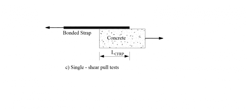

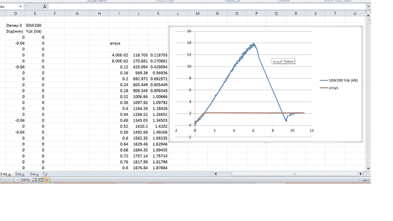

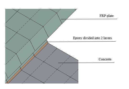

Hello All,
I am a master student working on my thesis. am using ANSYS workbench to model the debonding between FRP and Concrete (Single Shear Test). The geometry is very simple, so meshing and sketching were easy. however I have the following quires about loading and interfaces.
1. I want to apply a displacement controlled load ( at a rate of 2mm/min) to be exact, ANSYS provide you with three Load choices (Constant, Tabular or Function), How can I apply this load rate with these choices. do I have to play with the number of steps, initial, minimum, and maximum time step to apply this type of loading.
2. For this type of modeling (composites modeling) there are two methods to apply (Cohesive Zone Model "CZM" or Virtual Crack Closure Technique "VCCT"). these two methods need a surface/interface to be applied on. in my model I used CZM which is easy to apply, but on which surface/interface (FRP/Adhesive or Adhesive/concrete) interface. or within the adhesive layer it self by slicing it into two parts.
3. For the other Surfaces (contacts pairs), ANSYS automatically generates a bonded contact by default. is this the contact type I should use with my analysis, bearing in mind that in reality separation could occur in any interface (FRP/Adhesive or Adhesive/concrete).
Any help or suggestions will be highly appreciated.
Thanks in advance

1. So, yo want to apply velocity 2mm / min by means of displacement control. Let's say your end time is 1s. Given that displacement = velocity * time, it should not be a problem to find what displacement you need to apply. Or, if you have given displacement you need to solve for, then find appropriate end time.
2. I never modeled composites, so I am not a best person for this, but looking at your picture, I would probably delete adhesive layer and apply bonded contact between basic materials. Then you can specify a debonding condition for this contact. Knowing maximum load your adhesive layer can withstand, you can tune debonding condition accordingly. Just type "debonding" into workbench help, you should get some hints.
3. See 2.

Thank you for your reply Gobi. Really appreciate it.
I went through some articles and I reached the same point you said, that I should delete the epoxy layer and apply the CZM method (or any contact condition) on the contact region between the plate and the concrete, then I can implement the adhesive properties in it. this way I can model the debonding between these two materials.
Regarding your 1st point. I conducted the experimental program with a UTM machine. the load applied by the machine on the specimen was 2mm/min " Till the spacemen Failure". as you said, given the step end time and the load rate (2mm/min) I can find the displacement. however experimentally I loaded the specimen "till failure". my question is (if I applied the displacement calculated from the equation (displacement = velocity * time) based on the end time and the velocity, will the specimen fail, I tried it already and I think you are right (the result are still not close to experimental though), but I think this is due to contact, I have to work more on it).

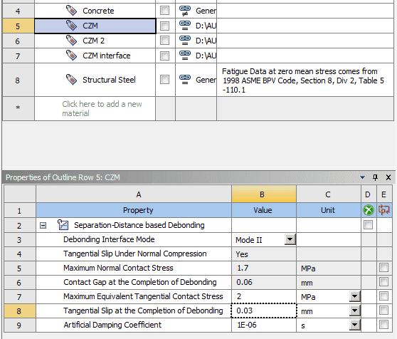

I am using ANSYS Workbench because the user interface is much easier than APDL. I don't have experience with APDL. but the parameters are directly depend on the experimental results (if you did some experimental). from the experimental data draw the (Bond Stress - Slip) curve and obtain the parameters C3, C4, C5 (mode II) based on models with approximately the same general trend, see the attached images for how to obtain the parameters. If you didn't conduct any experimental work then for sure you are trying to fit the curve based on some given data or previous paper, then see in that paper how they obtained these parameters (equations/models) and calculate the parameters from there. in case this didn't work then check one by one
1.materials properties (CFRP-Concrete-Epoxy)
2. Element Types
3.Contact
Best of Luck

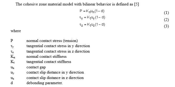

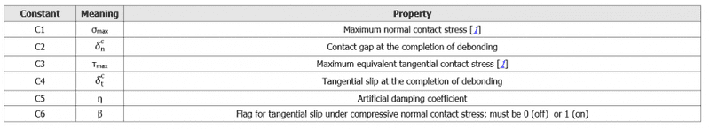

Hi Everyone,

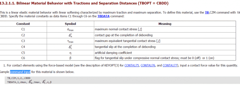

I tried to enter the above relationship as command in Ansys Workbench, but it didn't effect the results at all. I entered the command in static structural section as below. Please advice if you tried it before or there is something wrong in the command. (I used the value of the above example in the command just as an example)
TB,CZM,1,2,,CBDD
TBDATA,1,1.7,0.06,2,0.03,0.000001,1

hello, I don't know why do you want to use a command block for defining the CZM material in workbench, you can do exactly as the previous example you mentioned. just define a new material in engineering data and enter the parameter values. check the 1st video on top. its very helpful.
Thanks, Ahmed.
I tried as you said earliar but it is giving me very small values which is not close to the experimental results at all.
Can you define your problem?. what type of analysis you are doing??. did you conduct any experimental testing to compare your model with??

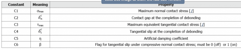

Hi Ahmed,
How do you know the material behavior parameters for CZM?
like (TBDATA,1,1.7,0.06,2,0.03,0.000001,1) in #9
hellow jeff,
if you look at #8 above you will see the graph relating the bond stress vs slip with the parameters defined (the graph in red), the excel graph above it (in blue) is generated using an equation depending on experimental strain gauge readings. if you did the exact same test with strain gauges then you can draw the bond-slip curve. if you did other tests on beams..etc, then you can use one of the bond-slip models available in the literature.

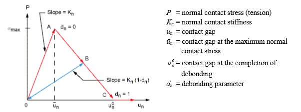

Hi Jeff,
you can do that if you used fracture based debonding. if you choose separation based debonding then you can do the following:
based on your simulation results. on the solution branch you can insert a contact tool and enter the following:
Frictional stress: the max value should be approximately as same value as the one entered in engineering data for the "maximum tangential contact stress".
Sliding Distance: the max value should be approximately as same value as the one entered in engineering data for the "tangential slip at completion of deonding".
other thing you can do is to turn animation on and see it actually debond "slide at the end of the animation"..
