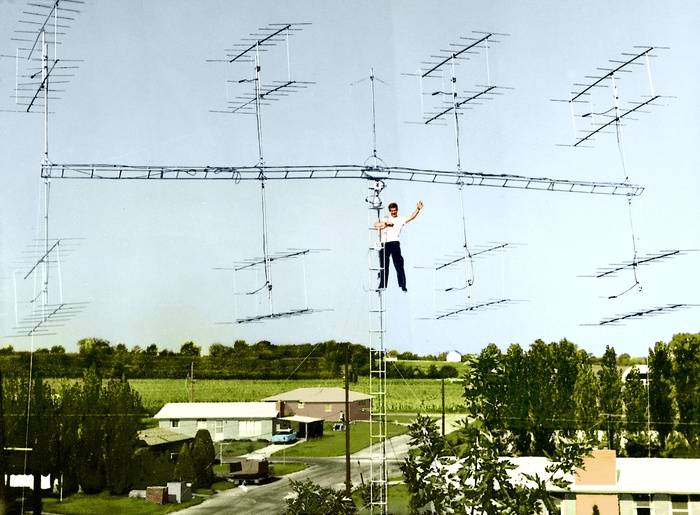

Just for amusement, I looked up designs for Yagi ants to see how long a high gain antenna would need to be. None of the design sites I looked at went above 20dBd. The online calculators simply ignored my settings or said they were impossible. The best I found was a 70cm yagi with 31 elements and overall length about 7.5m (equivalent to 10λ) for 19.9dBd (estimated). To get more gain it was suggested you could stack these at just over 2m spacing. So to get 28dBi you'd end up with an array at least 2m x 2m x 7.5m, or 8m x 0.4m x 7.5m. If the driven elements were 10λ apart, the antennae would almost completely overlap. If they faced each other not quite touching, the driven elements would be about 20λ apart. I think by any standards this can't be "far field".
Of course you could stack more shorter Yagis to get more air between the Tx and Rx, but it would still be an imposing sight.

something us ham radio guys like to get into :smile:
not mine, but definitely impressive 16 x 8 element yagis on 2m ( 144MHz) for moon bounce
approx. 22dBi gain
Dave
lets say 20 dBd for round figures
stack another yagi the same ( 2 in total) and you would have 23 dBd
stack 2 more yagis the same ( 4 in total ) you have 26 dBd
stack 4 more yagis the same ( now 8 in total ) and you have 29 dBd gain
Every time you double the number of yagis you add 3 dB ... that is, you double the gainDave
