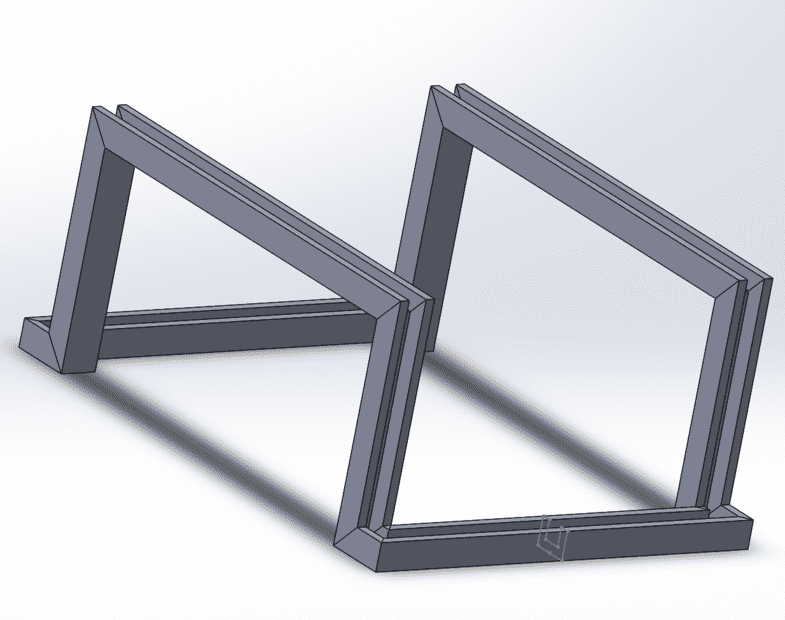

However, is it possible to estimate the inductance cooil of a 3D shaped coil? i.e, imagine a loop wire that runs along some of the edges of a cube doing several turns. I could not find any reference regarding this. I am trying to build different shape antennas for RFID low frequency devices (inductive coupling, 135 kHz). Any hint/starting point is appreciated.

Thank you for your answer. This is actually my question. I want to match a specific inductance value for the design of an inductive coupling antenna. A solenoid of square form is actually in the reference I mentioned (equation 26). The shape I meant is something like the attached picture, i.e., the loop wire would run along the shown framework. If I had just the upper face the geometry would be a plannar and eq. 26 could be applied to estimate the inductance.
Regarding your answer "... random winding which would tend to be non inductive", could you please elaborate more? My understanding is that this shape is also inductive, but I would like to obtain some analitical rules to estimate the inductance, i.e., number of turns needed to obtain a specific inductance value.

It looks similar to the saddle shape use for scan coils on a TV tube. Maybe find inductance of a flat coil, then bend it into the saddle shape, which will reduce the inductance slightly.
