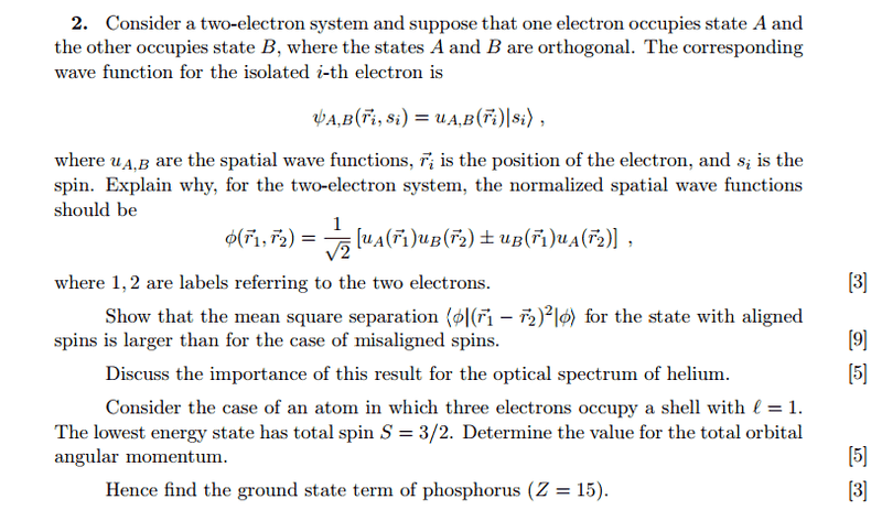

(a) Find the spatial wavefunction
(b)Show anti-symmetric wavefunctions have larger mean spacing
(c) Discuss the importance of this
(d)Determine the total orbital angular momentum
(e)Hence find the ground state term for Z=15[/B]
Part(a)[/B]
The overall wavefunction must be anti-symmetric due to Pauli's exclusion principle. Since the spin can either be singlet (anti-symmetric) or tripplet (symmetric), the spatial part must be written as a symmetric and anti-symmetric combination of ## u_{A(r_1)} u_{B(r_2)}## and ##u_{A(r_2)}u_{B(r_1)} ##.
Part(b)
Overlap leads to terms like:
[tex]\phi \phi^* = \frac{1}{2} \left[ | u_{A(r(1)} |^2 |u_{B(r_1)}|^2 + | u_{A(r(2)} |^2 |u_{B(r_2)}|^2 \pm 2 Re \left( u_{A(r_1)}u_{B(r_2)} u^*_{B(r_1)}u^*_{A(r_2)} \right) \right] [/tex]
Hence when spin is aligned (symmetric), the spatial part must be anti-symmetric.
Don't we get ## \phi_{AS} \phi_{AS}^* < \phi_{S} \phi_{S}^* ##?
Which is strange, as I know that spatially anti-symmetric wavefunctions are further away.

You haven't inroduced the ##(\vec{r}_1 - \vec{r}_2)^2## yet. Is there a fundamental difference then between the two wave functions?
The difference lies in the ##\pm Re \left( u_{A(r_1)}u_{B(r_2)} u^*_{B(r_1)}u^*_{A(r_2)} \right) ##. The anti-symmetric wavefunction has the ##-## sign, so the overall overlap is smaller? So the overlap becomes:
[tex]\langle \phi | ((\vec{r}_1 - \vec{r}_2)^2) | \phi \rangle = \langle \phi| r_1^2 | \phi \rangle + \langle \phi | r_2^2|\phi \rangle -2 \langle \phi | \vec r_1 \cdot r_2 | \phi \rangle [/tex]
The only way for the anti-symmetric wave function to be higher is when ##\int Re \left( u_{A(r_1)}u_{B(r_2)} |\vec r_1|^2 u^*_{B(r_1)}u^*_{A(r_2)} \right) d^3\vec r = \left( u_{A(r_1)}u_{B(r_2)} |\vec r_2|^2 u^*_{B(r_1)}u^*_{A(r_2)} \right) d^3 \vec r = 0## so that both ##-## signs coincide at the ## 2 \langle \phi | \vec r_1 \cdot r_2 | \phi \rangle ## to give a positive contribution to the sum.

##S=3/2## means that all the spins are aligned (+++), so the spin state is symmetric. Thus the spatial part must be anti-symmetric. Neon is represented as ## 1s^2 2s^2 2p^6 ##

But what happens to the wave functions at ##\vec{r}_1 = \vec{r}_2##?

Yes, but you have to include orbital angular momentum somehow in the picture.

When ##\vec{r}_1 = \vec{r}_2##, the anti-symmetric spatial wavefunction disappears while the symmetric one doubles. (Also, why are we equating ##\vec r_1 = \vec r_2##?)
If the condition that spatial part must be anti-symmetric, what does it say about the orbital angular momentum?
For neon, since the outermost is ##2p^6##, it means that ##L = 1##.

You now have to relate that to ##\langle (\vec r_1 - \vec r_2)^2 \rangle##.

Nothing in itself. That was my point. The fact that all spins are aligned should tell you something about the total orbital angular momentum. This is also the point for me asking about neon.
That's not correct. How did you arrive at that answer?

I'm thinking that ##\langle r_1^2 \rangle = \langle r_2^2 \rangle ##, so the expectation becomes ## 2\langle \phi | r_1^2| \phi \rangle - 2\langle \phi | \vec r_1 \cdot \vec r_2 | \phi \rangle##.
If all spins are aligned, total orbital angular momentum is zero? I'm not sure why though.
Since neon is a noble gas, the overall shell is symmetrical and hence ##L=0##?

Yes. You have to think in terms of ##m_l## to understand why in both cases.

But you are considering p electrons, so ##l=1## for each of them.
The thing you have to consider is that you can apply ##L = \sum l## naively only for electrons with different principal quantum numbers n. Otherwise, the Pauli exclusion principle will forbid some combinations (the actual equation is for operators, ##\hat{L} = \sum \hat{l}##, and the sum applies to allowed wave functions). What always applies is ##M_L = \sum m_l##, so you need to sum up ##m_l##'s for the electrons to get which ##M_L## states are present, from which you can deduce what is the corresponding ##L##. (For example, if you find ##M_L = 2## for a certain electronic configuration, then there is a D term associated with that configuration.)
There is a systematic way to go about it, where you list all the microstates (each electron in all possible orbitals with all possible spins) allowed by Pauli, figure out ##M_L## and ##M_S## for each microstate, and deduce the term symbols. For instance, if you do that with an np2 configuration, you will find three possible terms, 1D, 3P, and 1S. Your case is simpler.
