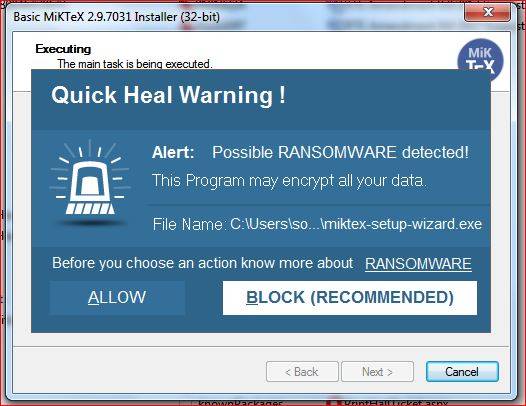

When I started installing MikTex, while the installation was half-way through, QuickHeal said that there was a ransomware in MikTex files, and stopped the installation. The only way to install now is to switch off the antivirus completely during the installation process, and then setting it to exclude the MikTex folder.
Can anyone confirm these are false warnings? I know that QuickHeal isn't a very good antivirus, but my father isn't ready to discard it before the license expires. I got similar warnings when I installed Frizing. Is there a chance that the installer file is getting corrupt while downloading? Or are these just false warnings that I can overlook?

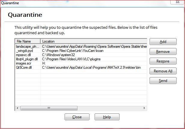

The texstudio.exe (suspected keylogger) is still in quarantine, but for MikTex (suspected ransomware), the antivirus completely deleted the file.

But QuickHeal says that the main executable file of MikTex is a keylogger, and has quarantined it (see the last file in the list):
Same for texstudio:
I believe I can set the antivirus to exclude these files, right? Seems like false positives.

Here's a link to a list of files in the MikTex distribution: https://miktex.org/Package/Browse/miktex-qt5-bin-x64
Qt5Core.dll is on the list.
I think it's safe to say that if you got it from mktex.org, it's not a keylogger, it's a legitimate file.
However, the Qt platform is used by other applications, and your AV product may recognize that the Qt5Core.dll file is registered to another product in the system registry, and therefore decide that your install is trying to tamper with another product's files. Speculation again: the Qt5core.dll file being common to multiple products, its name may have been used before as part of an exploit, and your AV product may have it flagged accordingly.
Python 3.5.0 |Anaconda 2.4.0 (64-bit) has the Qt platform, and consequently uses Qt5Core.dll.
You could do a global search for that file name, and check whether it's already there as part of another product.
As long as the MikTex version of Qt5Core.dll is installed only within its the MikTex directory structure, I think it's safe to whitelist it in your AV product.
For your recent installs of the 2 products, it may suffice to just hit the restore button on those files, and follow through with allowing it past any warnings.

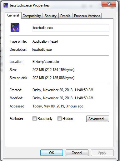

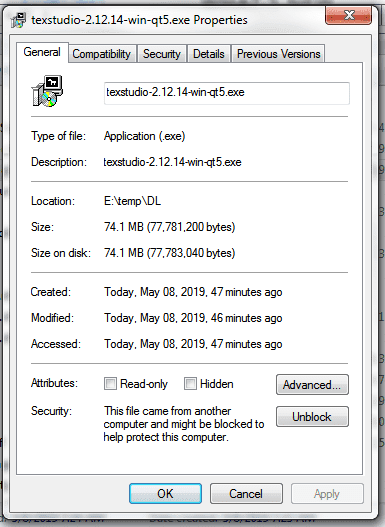

The Properties dialog for my just-installed copy of texstudio.exe looks like this:
243169
If yours matches that on the created/modified date/time, and on the byte count (there could be a small variance in the size on disk due to different device characteristics), I'd say it's safe to restore it from the quarantine.

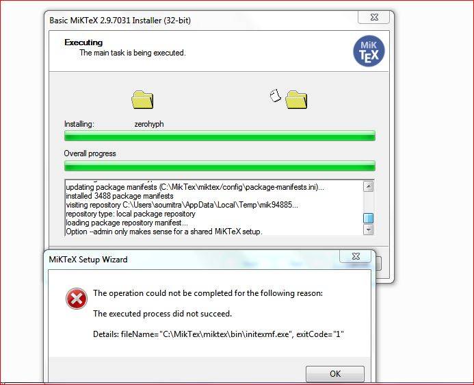

Sorry, but the installation attempt was a failure. I switched off the antivirus, but as MikTex was being installed, it blocked the setup wizard:
And then stopped the installation before I could do anything.

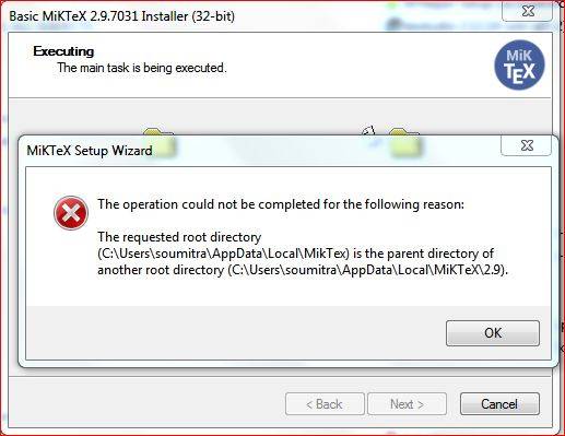

I tried again, now it gave a different error:
Basically MikTex wants an empty directory. Windows has denied the setup wizard access to C:\Program Files. If I ask it to install in any other directory, it is giving an error that the directory is not empty. If I make an empty folder and ask it to install there, it is giving the above error.

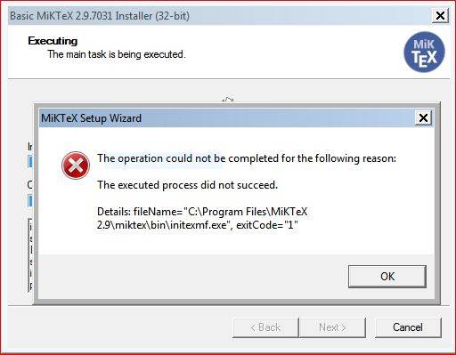

@sysprog Tried in Safe mode, but got this error:
This seems to be a well-known bug over the internet, with no fix unfortunately.
Same error came in Normal mode too (I bypassed the ransomware alert) when I tried later.
Try installing into a directory path that doesn't include spaces in any of the directory (folder) names.

Followed your advice word by word. Got the same error:

Thanks, could finally install MikTex properly (I installed in safe mode).
MikTex wants to set the PATH variable to its own bin folder. The variable already has the jdk address. I know I can set multiple addresses with the delimiter ;, but MikTex is not taking this. It wants to be the sole address in the PATH variable.
Any idea how I can keep both addresses (jdk and miktex) in PATH?

If you are having problems with installing for different types of user, make sure you right-click and run the installer as Admin.When having problems with an AV and installers, simply excluding the installer or folder it is in will not help, as the unpacked files are not the installer, they are new files in a new location.
You have to disable the AV temporarily. If it is still complaining, you didn't actually disable it.
At the end of the install process and before enabling the AV again you can exclude the new program folder.
The problem is that you now lose all protection of the contents of that folder so in future it could be full of malware.
Looking at your picture of the quarantined files it seems to have issue with Qt files in other software, so has obviously borked them or certain features. Either that or you have had a lot of bad downloads.
